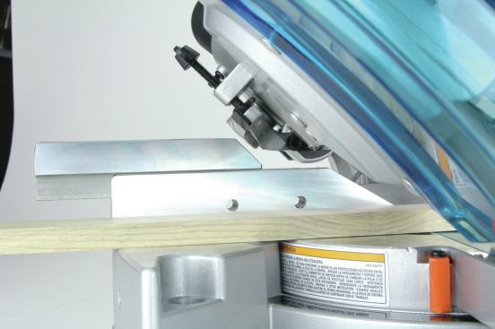

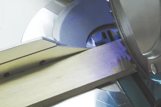

The main limitation of any miter saw is the height it can cut through material held vertically against the fence (vertical cut height). For miter joints in baseboard, chair rail, and window aprons (with their tiny returns), cutting with the material held vertically against the saw fence is faster and more accurate than cutting with the stock laid flat and the saw head tilted at a 45-degree bevel. Besides the relative difficulty of tweaking the bevel angle slightly to fine-tune a miter joint, the diagonal force applied to the sliding head can deflect the saw’s arm slightly and affect the accuracy of the cut.

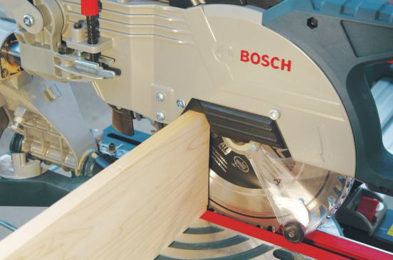

To increase the vertical cutting capacity of miter saws, some manufacturers put a notch in the blade housing on the left side of the blade, which lets you use the back half of the blade, above the level of the arbor bolt and washer, for cutting. The Bosch and the DeWalt reviewed here have this feature, but even with a notch in the guard, the motor housing to the right side of the blade will often be lower and limit cutting height. As a result, there are two ways to measure vertical cutting capacity.
One is a vertical “through cut” where the piece of wood standing against the fence goes beyond both the left and right sides of the blade, passing under the motor housing to the right. These cuts are typically made in chop mode with the sliding head locked all the way back on the rails. The second is a vertical “shave cut” used for fine-tuning; the material is held to the left of the blade and the waste piece is small enough not to extend under the motor housing.
Even with these distinctions, vertical cutting capacity will depend on whether you’re cutting at 90 degrees or at 45 degrees. And it also varies depending on whether you’re cutting square-edged 1-by stock or profiled baseboard that’s thinner at the top and thicker at the bottom. (The DeWalt is the only saw here that will through-cut a standing 1×4, thanks to a notch in the upper guard that continues to the right side of the blade.) But when you’re cutting profiled base, the thinner top edge fits up higher into the guard’s notch and allows a greater depth of cut. All of the vertical cut capacities listed in the specs are maximums, meaning I was cutting profiled material at 90 degrees. (To line up the tallest vertical cuts into the notches of the Bosch and DeWalt saws, you will have to lock down the saw head a bit forward of its farthest back position.)

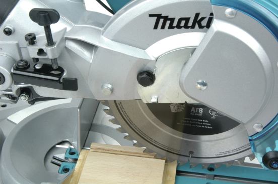

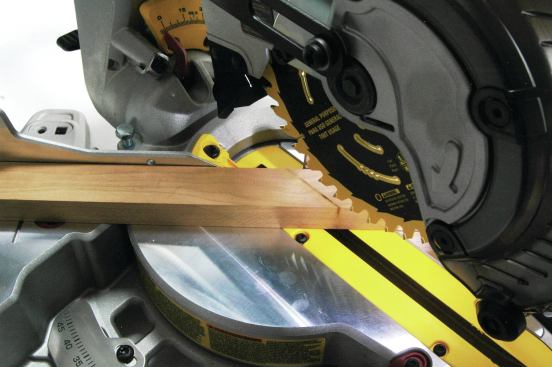

Though not usually thought of as a performance feature, the channel for the blade has a few notable components. The plastic inserts along both sides of the channel come from the factory set wide open so the blade won’t hit them while bevel cutting, but if you are doing non-beveled miter and crosscuts, it helps to move them close to the blade. That way small cutoffs won’t clog up the blade channel or go zinging off as shrapnel after making contact with the blade. All but the DeWalt saw have adjustable plastic inserts.
Also useful are simple slots in the blade channel that let the sawdust drain out. Without the holes, the channels fill up quickly and have to be blown out or vacuumed. Leaving the channels full adds a lot more airborne dust with every cut as the blade dips down into this “sawdust dispenser.” The DeWalt and corded Makita both have slots, but the multiple slots of the DeWalt do a much better job.
The Bosch saw even has a little ramp leading out of the blade channel that allows errant cutoffs to slide up and out effortlessly. Other saws trap thin scraps in their channels where they have to be fished out manually or are forcibly ejected when the blade strikes them.

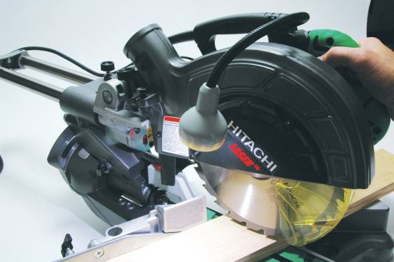

The Hitachi features both a laser line and an LED light, and curiously, the light can be switched on only if the laser is switched on, though they have separate switches. The laser is fine and the light works wonderfully. It’s super-bright and is mounted on an adjustable arm that lets you point it where you need it. It’s even bright enough to be of help outdoors.

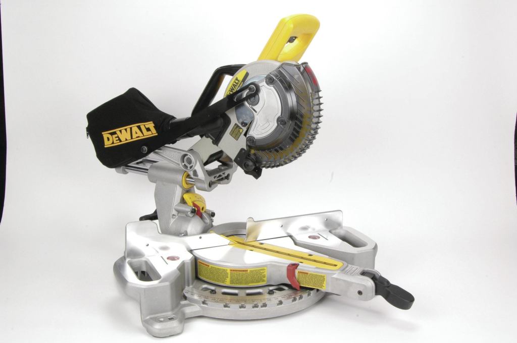

Cordless 7 1/4- and 7 1/2-inch Saws
DeWalt DCS361M1
Motor: 3,750 rpm; no brake
Battery: 18-volt (20-volt nominal), 4.0 amp-hour
Blade: 7 1/4-inch, 40-tooth, 7-degree rake angle
Miter angle (in degrees): 49 left to 48 right; stops at 0, 10, 15, 22.5, 31.6, 45
Bevel angle (in degrees): -3 to 48; stops at 0, 45; marks at 22.5, 33.9
Horizontal cut width: 8 1/8 inches at 90 deg., 5 13/16 inches at 45 deg.
Horizontal cut depth: 2 15/16-inch shave cut; 2 1/2-inch through cut
Vertical cut height: 3 3/4-inch shave cut; 3 3/4-inch through cut
Runtime (cuts of 2×4 on a battery charge): 166
Dust-bag collection (50 cuts of 2×4): 46.9 grams
Weight: 31.6 pounds
Price: Kit, $399; DCS361B bare tool, $319
Includes: Battery; charger; blade; dust bag; material clamp; onboard wrench
Country of origin: Tool, Mexico; battery, Japan
Performance: Cuts twice as fast and long as the Makita. Great vertical capacity, but limited horizontal cut width.
Comments: Impressive cutting ability for an 18-volt cordless saw. Useful for a range of building projects—not just cutting trim.
Pro: Smooth starts, quiet operation.
Tall and wide notch through both sides of the upper blade guard allows for the tallest vertical through cuts of any saw in the test. Horizontal handle and trigger with embedded lockout lever easy to use.
Multiple dust slots in the blade channel do the best job of letting the sawdust drain out.
Cut-line light helps to illuminate pencil line in shadowy conditions.
Con: No motor brake, but quick run-down time of 1 1/2 seconds is tolerable.

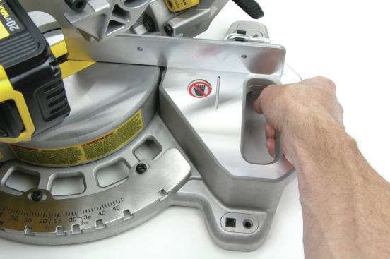

Most limited miter range among compact sliders.

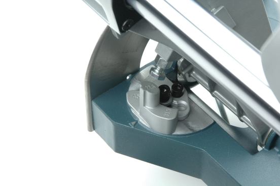

Mark for 33.9-degree crown-molding angle on bevel scale, but no stop. Requires tool to bypass 0- and 45-degree bevel stops.
Slight deflection (1/32 inch out of square) on 8-inch-wide beveled crosscut.
Blade channel inserts not adjustable toward the blade, so this saw collects the most scraps in the blade channel.
Sub-par dust collection.
Adjustments required: came with fence bowed out .020 inch.
Only saw without an adjustment for blade depth, so can’t be used for cutting dadoes and rabbets.

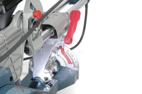

Miter angle (in degrees): 54 left to 60 right; stops at 0, 15, 22.5, 31.6, 45 (also 60 to right)
Bevel angle (in degrees): -2 to 47; stops at -2, 0, 22.5, 33.9, 45, 47

Pro: Tall notch in the left side of the upper blade guard allows for the tallest vertical shave cuts of any saw in the class.
Only saw with a miter detent lockout to allow smooth passage across the entire miter scale. Most advanced bevel-angle setting with simple bevel-locking lever within easy reach and with multiple angle stops. Easiest saw to tweak the bevel angle slightly.

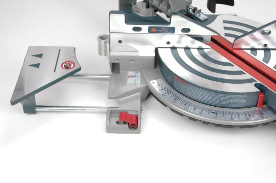

Left and right sides of the saw table extend outward on sliding arms to provide support 6 inches further out.

Table extensions must be opened to access entire miter range of saw.

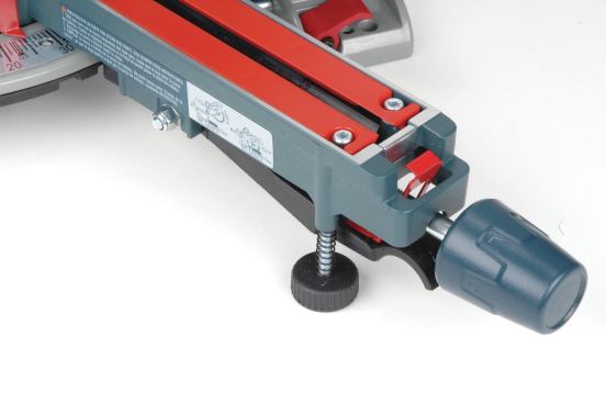

Saw travel awkward, starts too high up for economy of motion, and the excessive spring tension combats the ease of use.

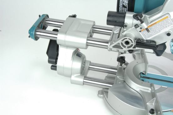

Makita XSL01
Motor: 2,200 rpm; brake
Battery: 18-volt, 3.0 amp-hour
Blade: 7 1/2-inch, 40-tooth, -18-degree rake angle
Miter angle (in degrees): 48 left to 58 right; stops at 0, 15, 22.5, 30, 45; mark at 31.6
Bevel angle (in degrees): -5 to 45; stops at -5, 0, 45; mark at 33.9
Horizontal cut width: 12 3/8 inches at 90 deg., 8 11/16 inches at 45 deg.
Horizontal cut depth: 2 15/16-inch shave cut; 2 11/16-inch through cut
Vertical cut height: 3 1/4-inch shave cut; 3 1/4-inch through cut
Runtime (cuts of 2×4 on a battery charge): 84
Dust-bag collection (50 cuts of 2×4): 5.4 grams
Weight: 27.3 pounds
Price: Kit, $769; XSL01Z bare tool, $450
Includes: Battery, charger, dust bag, material clamp, side support arms
Country of origin: Tool assembled in U.S.; battery, Singapore and China
Performance: Slow cutter due to very low motor rpm and extreme negative rake angle of blade teeth. Shorter runtime, too. Limited vertical cut capacity, but excellent horizontal cut width.
Comments: Though relatively low on power and runtime, this saw is the one to get if you want a cordless saw with the sliding crosscut and miter range to match the larger corded saws. This saw is essentially a cordless version of the LS0714, a corded 7 1/2-inch slider that Makita recently discontinued. It also can be easily adjusted to run a 7 1/4-inch blade.
Pro: Smooth starts, quiet operation, quick motor brake.
Showed no deflection on 9-inch-wide beveled crosscut.
Nice one-finger trigger and easy-to-reach trigger-lockout button on the back of the saw handle.
Removable extension arms add a point of support 9 inches out from both sides (or just one side) of the saw table.
Medium-easy blade changing.

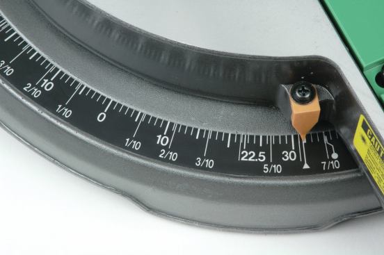

Con: Miter stop at 30 degrees, not the more common 31.6 degrees used for crown.
Difficult bevel-scale visibility. There’s a mark for 33.9-degree crown-molding angle on bevel scale, but no stop.
Negligible dust collection—blade much too slow to move dust effectively into the bag. Also, most of the dust pushed up toward the bag dumps out when the head is tilted forward to make cuts.

Con: Difficult bevel-scale visibility and no recognition of the 33.9-degree angle used when cutting crown on the flat. Bevel stops a bit indeterminate, feel soft.

The best LED light of any saw tested, mounted on a flexible arm to point where it’s needed and bright enough to add illumination in daylight. Paired up with the only laser guide in the test.
