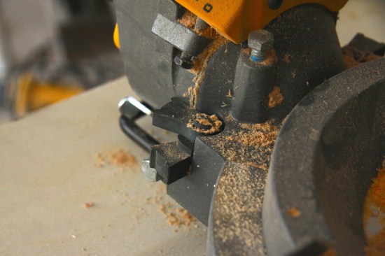

Adjustable positive stops for crown. Two pawls provide positive stops at 22.5 degrees and 33.9 degrees; they can be reversed for 45/45 crown. A chrome lever toward the back provides positive stop at 45 degrees and flips out of the way to achieve a sharper bevel.
The bevel adjustments are also nice and include the ability to go just beyond 45 degrees to about 50 degrees, which is great on outside corners when we’re running trim. The adjustment includes two “pawls” that swivel out on each side—one for 22.5 degrees and the other for 33.9 degrees. We cut crown both on the flat and nested—and found the saw accurate in both positions. Typically, we’re cutting preprimed pine and poplar. We had no deflection issues with the poplar and didn’t cut anything harder than that with the cordless saw. The corded DWS780 has done well for us with hardwoods, so I assume this saw will as well. It was cutting square to the fence right out of the box, though we had to adjust the bevel stops slightly. The fence does get in the way of the large motor when tilting to the left, so that’s something to be aware of on bevel cuts.
