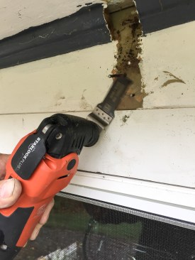

Fifty-plus years later, oscillating multitools are as important to most trim and renovation carpenters as their hammers or circular saws. The tools excel in making precise plunge cuts, excising broken tile, removing dried glazing from a window sash (without breaking the glass), and can be used to cut or sand basically everything and anything that’s hard to reach. I’ve road-tested the new Fein MultiMaster for the last few weeks, and from what I’ve seen, Fein hasn’t lost any ground to its legion of competitors.

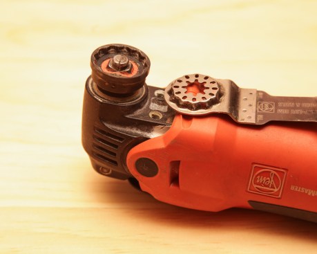

One feature that really defines this little machine is the StarLock blade-attachment design, something that Fein and Bosch developed a few years ago. The blades are shaped to fit exactly onto the tool and snap into place. There are no bolts or adapters to lose, and the blades do not move or come loose in service, even when bending under the hand an over-enthusiastic operator. Changing the blade is a one-handed operation so you don't have to touch a hot blade, which is nice. These new blades come in three versions: Starklock, Starlock Plus, and Starlock Max; the MultiMaster that I tested works with all but the Max. Read more about the blades here. These blades are compatible with most all other manufacturer's multi-tools, with some exceptions. DeWalt, for example, requires a special adapter. To look up compatibility by brand and model, click here. I used the StarlockPlus blades, which are not cheap, but they do seem to keep their edge longer than most other blades I've used.

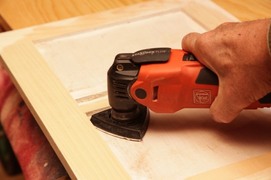

Fein offers an entire catalog of accessories for this tool that includes wood- and metal-cutting blades, carbide rasps, and several different sanding and polishing accessories. I especially like the different sanding profiles that range from finger width to 4 ½ inches in diameter. They make sanding into tight spots much easier.
