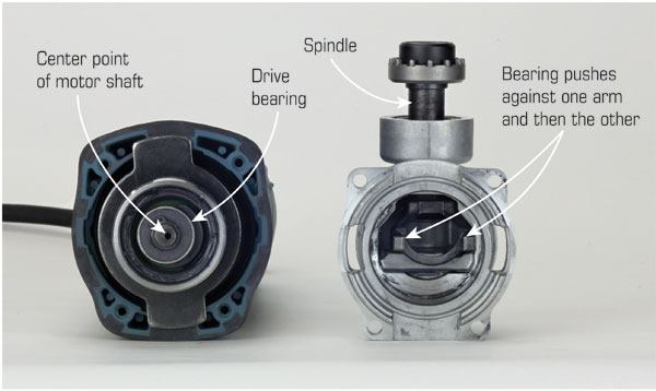

The mechanism that gives these tools their oscillating action is quite simple. A bearing — slightly off-center with respect to the motor shaft — fits between a pair of arms that are connected to the blade-mounting spindle. With each turn of the motor, the bearing pushes the arms one way and then the other. It’s a miniscule movement, but the high number of oscillations per minute (opm) allows the tool to work effectively. The opm matches the rpm of the motor, so at top speed the teeth on a cutting blade (which cut in both directions) could be taking 40,000 bites per minute.
The small angle of travel (between 2.8 and 4.0 degrees) accounts for the ease with which OMTs can be controlled as they cut, sand, and scrape. Because of the spindle’s limited throw, the triangular sanding pad does not bounce out of corners. Scraping works in an unexpected way: The intense friction at the tip of the blade actually melts and softens old mastics and sealants — something you can’t achieve with a putty knife.

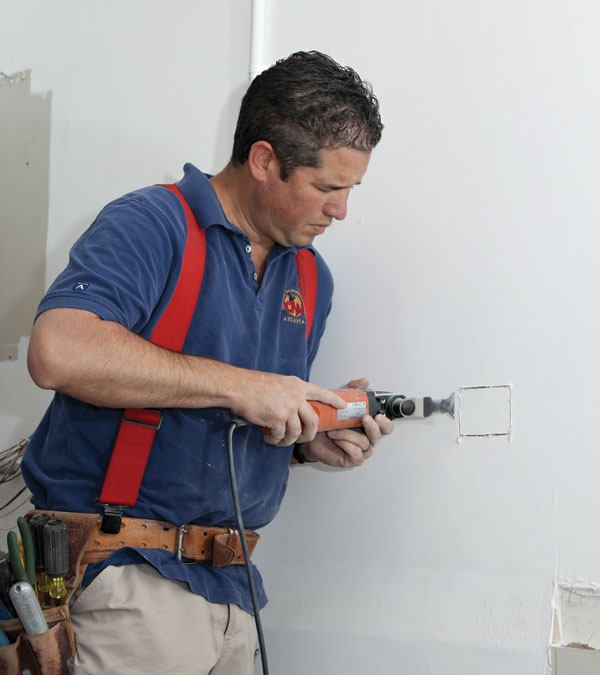

To see what the tools could do, I spent several days using them for the kinds of tasks they’d be asked to perform on the job site. I cut baseboard in place over drywall, notched trim and framing, cut through drywall and floppy cabinet backs, and trimmed 1-by jamb material. When I wasn’t cutting, I was sanding wood, removing grout, and scraping off old mastic. Click here to see my observations on the OMTs’ performance.

The end of the motor shaft is milled slightly off-center so that the drive bearing moves side-to-side as the motor spins, pushing the spindle one way and then the other. Each rotation of the motor produces one oscillation.
