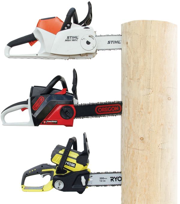

THE SAWS
The three saws hit different price points: There’s the premium Stihl MSA160C-BQ, the less-expensive Oregon PowerNow CS250E, and the economical Ryobi RY40510.
The Stihl is sold a la carte with two different battery and charger options, the Oregon is available in kit form with two battery options, and the Ryobi is sold as a kit or bare tool. I received a charger and one battery with each of the tools and opted for the higher amp-hour (Ah) batteries with the Oregon and the Stihl.
FEATURES
All three units rely on low-kickback-rated chains and bars, but the Stihl and Oregon saws have the additional safety feature of a chain brake that mechanically stops the chain if there’s a kickback. The Ryobi relies on a tip guard to keep the nose of the bar from entering a cut. It works when it’s in place — but since it reduces cut capacity to a meager 9 inches, most users will be tempted to unscrew it and set it aside.
As an additional safety feature, the batteries in the Oregon and Ryobi can be placed in a secondary position where they are electrically disconnected. The batteries are secure in this position (they won’t fall out), but the tool can’t be operated until the battery is pushed the rest of the way in. The Stihl lacks this feature; if you fail to fully engage the battery (at which point it’s electrically connected), it could fall out if the saw is knocked over during transport. However, the Oregon and Stihl saws can be electrically disconnected even faster by clicking their brake levers forward the same way gas saws are mechanically locked.
Bar adjustments
The tool-free tensioning mechanisms on the Stihl and Ryobi make it easy to keep their chains properly tensioned. Oregon requires the use of a screwdriver, which — combined with the clumsiness of the tensioning operation — made me dread (and delay) having to perform this adjustment.
Oiling
Automatic oiling of the bar and chain is a must — and all three chain saws do it well. The tanks hold enough oil for a few charges’ worth of cutting and have clear sight windows so you can tell at a glance how much is left.
Other notable features
The Stihl has a brushless motor and a battery with the highest Ah rating (4.5 Ah) I’ve ever seen on a cordless tool. These features represent the latest in cordless technology, though they are not played up in the product literature.
Another great feature of the Stihl is the active coast-down brake, which functions like the brake on a cordless drill, bringing the chain to a rapid stop when you release the trigger. It provides an added margin of safety and allows you to move more quickly between cuts.
The Oregon saw has a built-in sharpening stone that works with the included PowerSharp chain. By pushing on the stone’s lever for a few seconds, you can touch up the edge of this oddly shaped chain pretty well; it’s a handy time-saving feature. The saw also accepts standard 3/8-inch low-profile chains, but the sharpening stone doesn’t work with them.
