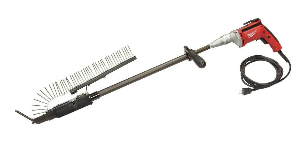

National Nail Camo Edge Pro
The Camo Edge Pro is an innovative way to install decking with hidden screws. It’s basically a jig for toe-screwing a large number of fasteners in a short period of time. The installer hooks the nose of the driver on the edge of the decking to ensure the proper screw angle, then turns on the drill and drives the fastener. The system works with Camo’s patented double-threaded screw that grabs the framing while pulling the deck board tight. Unlike other hidden fastener systems, the Camo method allows a single board to be removed for replacement. The tool can be used for decks with no installed gaps, or with a spacer system to create gaps between boards. Price $380 / COO: Drill, China; Attachment, Taiwan. /Camofasteners.com
