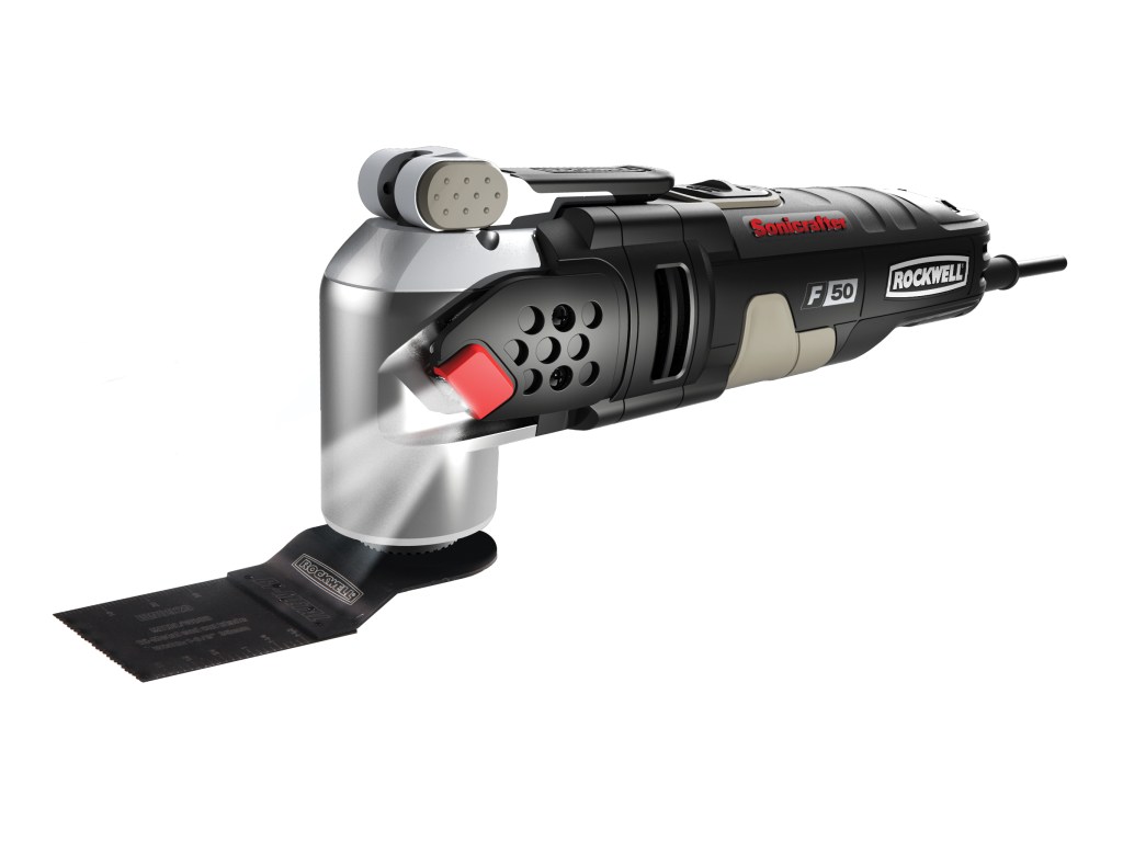

This manufacturer's "beauty shot" shows how the integral LED light illuminates the immediate work area.

I like the LEDs (one on either side) because they light up the nose of the tool. They were a help when I had to cut an outlet into wainscoting and I could see them being beneficial to someone undercutting door casings. Since oscillating tools are so good at precise cuts, it’s nice that the cut line is lit.
