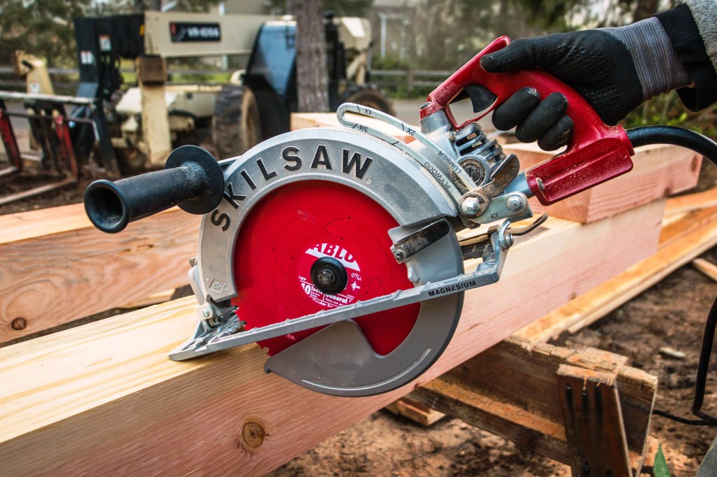

Skil wormdrives have been a west coast staple for decades. After recently rebranding itself as Skilsaw, the company introduced a beam saw they call Sawsquatch—a 10 1/4-inch blade left wormdrive (SPT70WM-22). Our crew has been using beam saws since 2002 so I really wanted to try this one out. Tools of the Trade contacted Skilsaw and they sent me a Sawsquatch.

I particularly like the anti-snag guard, which is similar to the guards on the 7 1/4-inch Skilsaws I reviewed last year. The guards on those saws worked
We use two beam saws when framing walls. The person doing layout uses one for gang cutting wall plates. We gang cut them to insure they are exactly the same length. The other framer uses the second beam saw to gang cut trimmers, blocking or anything that can be cut more than one piece at a time.
Sawsquatch Features and Performance
Skilsaw’s 10 1/4-inch wormdrive has features the Big Foot does not, such as brass gearing, a magnesium motor housing, and a dual-field motor designed to stay cool while cutting large timbers and engineered beams. The blade runs true (no wobble), the guard works well, and the motor and gears feel and sound smooth (smoother than the ones on our Big Foot with a Bosch body).
well and this one does too.
Sawsquatch is equipped with a rafter hook and comes with a Diablo thin kerf blade, our preferred brand for framing. We’ve used these blades for years and they have proven to be durable. I like the handle that screws into the upper guard housing because it allows me to stabilize the saw with my left hand. On remodeling jobs we’ll mark new window openings on the outside of the building and plunge this saw in to cut through the existing sheathing and studs—finishing off with a recip saw. It’s faster and more accurate than using a recip saw for the whole thing.
