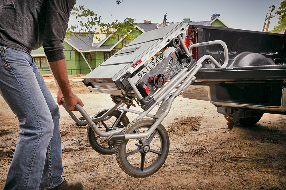

Big wheels and a sturdy frame. The SPT99 comes with a zero-gravity rise stand that’s equipped with 16-inch wheels. The large wheels are stout and sturdy, making it extremely easy to maneuver around a rough jobsite or up stairs. While the saw is heavy, it loads easily into the back of a pickup.
Skilsaw Big wheels and a sturdy frame. The SPT99 comes with a zero-gravity rise stand that’s equipped with 16-inch wheels. The large wheels are stout and sturdy, making it extremely easy to maneuver around a rough jobsite or up stairs. While the saw is heavy, it loads easily into the back of a pickup.

After assembling the stand and mounting the saw to it, I loaded the unit into the back of my truck. While loading the unit, I noticed that it’s heavy: With the stand, the saw weighs in at close to a hundred pounds. Many portable table saw stands have smaller wheels, but this stand’s wheels are extra large, at 16 inches in diameter. The large wheels made rolling the saw across rough terrain and up stairs very easy.

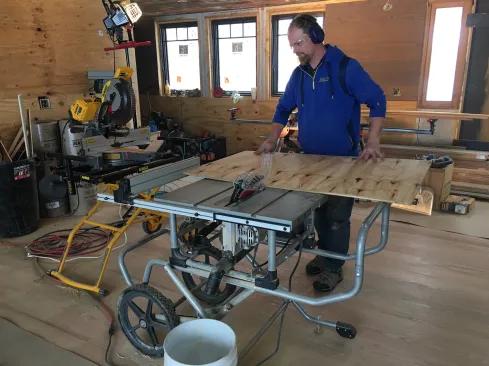

The rack-and-pinion-style fence is easy to adjust and was accurate out of the box. Locking the fence in place is done via a cam lock that snaps securely in place. Total rip capacity is impressive at 30 1/2 inches. As on other saws on the market, the fence features a flip-over guide for ripping thinner material. Another nice feature of the saw is that all accessories store on board.
After using this saw for a few months, I can attest that it cuts very well. The model that we received came with a 30-tooth Diablo blade, which cut well until someone hit it with a screw. We then ran it with a 60-tooth Diablo finish blade. The saw cut smooth as glass in oak and anything else we ran through it—producing really nice glue-line rips.
Wide rip capacity with a side support. The table saw has a 3 5/8-inch depth of cut and a 30 1/2-inch rip capacity. Once opened, the stand’s handle acts as a support for sheet goods. Adjustable feet allow you to fine-tune the stand’s base. A removable elbow allows you to direct dust into a bucket.
Chris Ermides Wide rip capacity with a side support. The table saw has a 3 5/8-inch depth of cut and a 30 1/2-inch rip capacity. Once opened, the stand’s handle acts as a support for sheet goods. Adjustable feet allow you to fine-tune the stand’s base. A removable elbow allows you to direct dust into a bucket.
