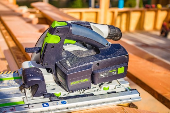

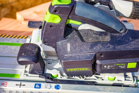

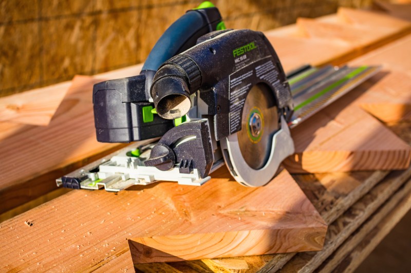

This saw is a cordless brushless saw that uses a 6 ¼” blade. You can purchase this saw in two kits. One with a rail and one without, but both come with 2 5.2 Ah Li-on batteries, 18 tooth blade and a SYS 4 Systainer and charger. The kits are also available with a corded saw, the HK. This corded version is nearly identical to the HKC with all of the same features except that it is also equipped with a speed adjustment knob. With more control over the motor you have more options for cutting various materials like metal, PVC or laminates; material-specific blade are available as well. I used a 18-tooth framing blade.
This is a blade left saw that bevels to 50°. The depth adjustment differentiates between using it with the track or without, and is very accurate with clear markings. It can also be turned into a plunge saw and used with other Festool guide rails. There is a dust port that can either be hooked to a bag or vacuum. The dust port features a new design that locks with the new locking hose fitting and works on all Festool dust extractor connections.

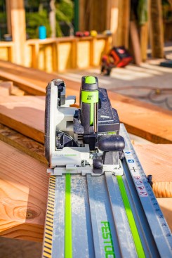

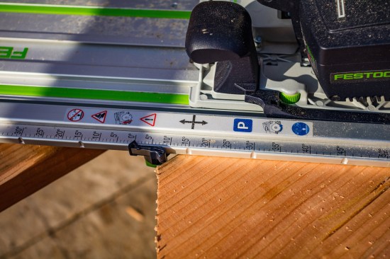

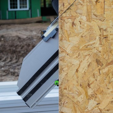

These tracks are different than other Festool tracks in that they hook to the saw to become a unit and they are self retracting. What’s even better, they can be set to an angle up to 60° making it easy to achieve shop-quality repetitive miters. These rails come in three lengths: The FSK 250 (9.84 inches), the FSK 420 (16.53 inches) , and the FSK 670 (26.38 inches). All guide rails include an integral splinter guard.
On the underside of the guide rail is a plastic pivot as well as an adjustable “stop”. You simply put the track on the piece of lumber and rotate the saw and rail until both the pivot and stop are up against the material; this automatically fixes the angle. You can adjust the angle to register to either the left or right relative to the material.

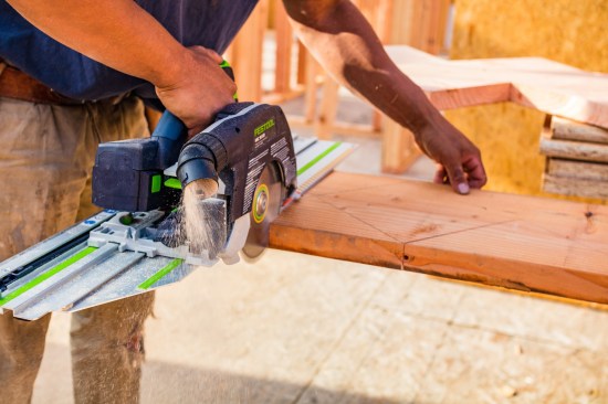

Let’s take the dust collection first. I didn’t use this saw with a vacuum or bag. I angled the port down and to my right because that keeps the dust off the track and material I’m cutting. I found that I cut right handed with my left hand on the track. Whichever hand you use, you will likely want to have your free hand holding the track down in front - particularly with larger material. While Festool doesn’t claim that this saw collects all dust, I found that I had basically no dust on the surface I was cutting. I used this HKC-55 saw to cut 3 stair stringers, all of my 2x8 riser material and 1” OSB tread material, then took the saw off the crosscut rail and used it with one of the FS tracks to rip the treads. During all of this, my workstation stayed clean.
The saw had plenty of power for cutting through really dry 2x12 Doug Fir. I kept a steady speed and didn’t force the saw. I don’t have any complaints about power. The depth was easy to set, guard was easy to retract via a convenient lever just to the left of the blade - although I only used that lever to test the saw, I didn’t actually need to use it as I worked. You can set this saw into a plunge mode which retracts the blade completely up; as you’re cutting from this mode it is nice to be able to raise the guard with the lever. Once we framed the house and papered the roof we could use this saw inside doing pick up work. I found it about as fast to use it and a long rail ripping sheathing for shear walls as snapping a line and cutting.
The guide rail works very well. The splinter guard aligns precisely on the cutline just as with the FS track. I didn’t set the angle to cut the riser and tread lines on my stringers; I could have but I found that it was easy enough and fast to set the track on the line and cut. Like the FS track, the FSK guide rail has rubber strips along the bottom which helps it to stay on the material without slipping.

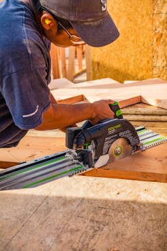

We got this saw in time to frame a roof that had I-Joist rafters. In addition to the rafters I had nearly 100 10” web stiffeners to cut. I had planned to bring our sliding compound miter saw and stand to cut them but forgot the stand (idiot move). I instead used the HKC and guide. I set the angle to ­30° and quickly cut 100 5/4x8 10” web stiffeners with 30° miters on each end. I went through 1 ½ batteries.
What I noticed is that every 20 cuts or so the rail was failing to retract so I took the saw off the rail and shook out the rail. This was ok with me because even while using a guide my shoulder was getting a workout.
