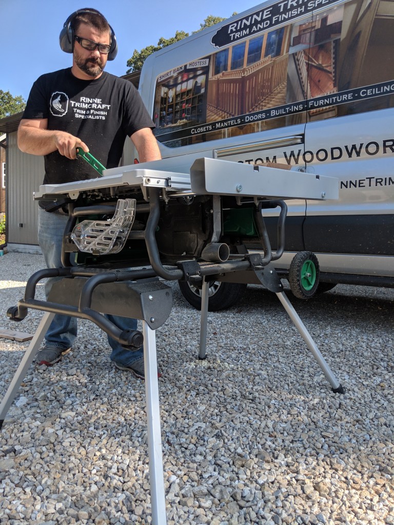

On-board storage for the kickback pawls, push stick, auxiliary fence, and miter gauge is excellent underneath the saw.

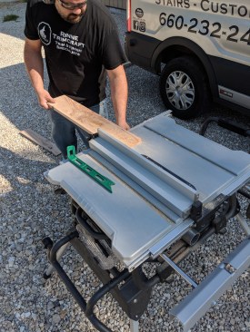

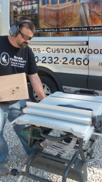

The author cuts lots of 3/4-inch hardwood and plywood for his trim-carpentry business. Not only did the Metabo HPT power through it all—with the included blade—but the table surface is much larger than that of other cordless units on the market.

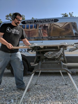

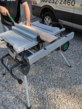

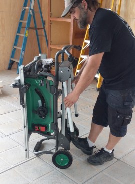

The bolt-on stand works. The fold-down, ball-sockets form a stable platform. Are they the toughest steel in the world? Maybe not. But the author has no complaints so far.

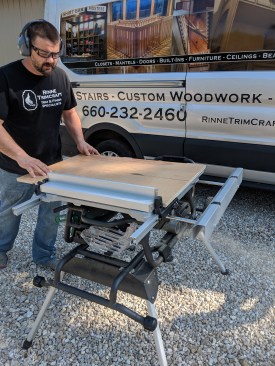

The author loved the end-of-table outfeed support. Editor Mark Clement, who cuts different lumber—heavier PT stuff—than he does noticed that it changes the balance point of the tool, enabling, in some cases, too much weight to get out in front of the saw.

You read that right: 10-inch, as in full-on 3 1/8-inch depth of cut at 90 degrees versus 2 1/2 inches at 90 degrees on smaller saws. And a nice, big table surface that works for me and the work I do.
While other manufactures are offering blade diameters of 8 1/4 inches with rip capacities at or under 25 inches, Metabo HPT went all in with the 10-inch blade and a whopping 35-inches of rip capacity to the right and 22-inches to the left—more than any other cordless or corded jobsite saw save Metabo HPT’s corded version of this saw.

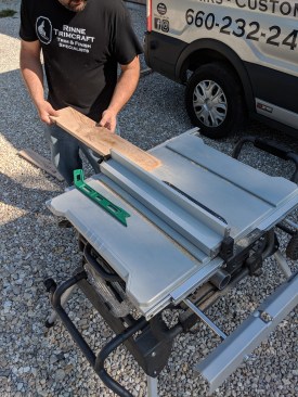

Rack-and-pinion fences are the best. Release, adjust, lock, cut.

This saw appears to be well made with features that I’d say show a great deal of forethought in the design. For starters, the onboard storage is second to none. It holds the blade-guard assembly, small parts, auxillary fence, included push stick, miter gauge, and the anti-kickback pawls all within easy reach. The large table surface (28 3/4 by 22 inches) is backed up with an indispensable adjustable out-feed support bar that you will wish you had on every saw you own. [Editor’s Note: For heavier stock like 2-by PT, this support can work against you because it extends the balance point of the saw out in front of the table. If too much weight gets in front of the saw, it can tip. This is important to know if your work requires ripping heavier, longer stock; personal experience—MC]
The rack-and-pinion-style fence is the most easily adjustable fence system I’ve used. A simple release lever unlocks the dial, which in turn can fine-tune for a cut with relative ease. The fence also has a secondary narrow fence that, when flipped into the horizontal position, is used as a work support for pieces wider than the table top.

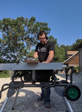

The built-in wheel kit on the stand was great for rougher terrain like coarse gravel and it made load-in/load-out much easier than lugging a saw body.
The stand deploys and breaks down easily. Boom!
OPTIONAL STAND
The optional stand features a design that makes one-person transport much easier. Wheels that have no trouble going through gravel and other terrain make the tasks of pack-in and pack-out a bit easier. The legs operate much the same as my miter-saw stand; with a spring-loaded ball catch. They both unfold and collapse them easily. The metal used isn’t what I’d call heavy duty, but it does the job. No problems so far.
Pro? Con? One thing that could be seen as either a pro or a con, the saw must be mounted to the stand with bolts. Some would prefer a quick release to separate the two and would see this as a con. Others find it makes setup faster and simpler to carry the saw and stand together. One thing worth noting, the saw and stand together have a fairly large footprint. You aren’t going to throw this in the backseat of your Honda Civic by any means. Transporting this saw is best left to those with a van, truck, or trailer.
