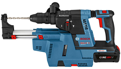

Bosch GBH118V-26K24GDE drilled 24.5 holes with a 6.3-Ah battery, which works out to be .25 Ah per hole. The HEPA filter on the dust extractor has a small window to show how full it is. The maximum bit diameter this tool will use is 1 inch in concrete. The drill has kick-back control to stop the bit when it binds, say, if you hit rebar. The drill, two batteries, and charger fit in the case, but not the extractor accessory.
This Bosch kit sells for $599 The kit includes the GBH18V-26 18V EC Brushless 1 Inch SDS-plus Bulldog Rotary Hammer, two GBA18V63 CORE18V 18V 6.3-Ah batteries, GDE18V-16 SDS-plus Dust Extraction Attachment, 18V Fast Charger, Auxiliary Handle, Depth Gauge, and Carrying Case that doesn’t fit the extractor attachment.
Specs:
No Load Speed: 0-890 rpm
Impact Rate: 0-4,350 bpm
Impact Energy: 1.9 ft.-lb.
Max Bit Capacity: 1-inch SDS-Plus

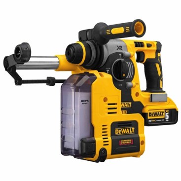

DeWalt DCH232P2 equipped with the DWH303DH extractor attachment drilled 14 holes on a 5-Ah battery, which works out to be .35 Ah per hole. This drill is compact and manages vibration well, and the clear HEPA filter made it easy to see how full the filter was. This tool maxes out at a 1-inch bit in concrete. The drill comes as part of a kit that fits in a plastic case. The tool, charger and two 5.0-Ah batteries fit in the case. The dust extractor is separate and doesn’t fit in the case.
The DeWalt rotary hammer drill kit retails for $529. The dust extraction attachment is $169. Total for this setup is $700. The rotary hammer kit includes two DCB205 5.0-Ah Batteries, DCB101 Charger, 360-Degree Side Handle, Depth Rod, and Retractable Utility Hook. The dust-extraction attachment includes the unit and a side handle.

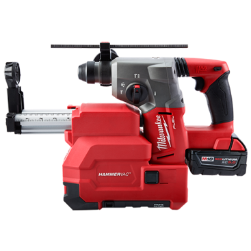

Milwaukee M18 Fuel 2712-22DE drilled 16 holes on a 5.0-Ah battery, or .31 Ah per hole. This dust extractor is the largest of the bunch and so holds the most dust. Max hole size in concrete is 1 inch. The drill, two batteries, dust extractor, and charger fit into a large plastic case. There is no way to see into the filter and tell how full it is. The rail on the dust extractor has a ruler which can help as a gauge, though the tool does ship with a separate depth gauge.
The kit sells for $599. It includes the M18 FUEL 1-inch SDS Plus Rotary Hammer, an M18 Hammervac Dedicated Dust extractor (2712-DE), an M18 & M12 Multi-Voltage Charger (48-59-1812), two M18 Redlithium XC5.0 Extended Capacity Battery Packs (48-11-1850), Side Handle, Carrying Case, HEPA Filter, and Depth Rod.

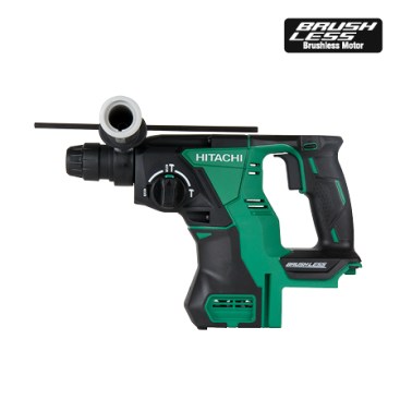

Metabo HPT (formerly Hitachi Power Tools) DH18DBLP4 + 402976 drilled five holes on a 3.0-Ah battery, or 0.6 Ah per hole. This doesn’t really tell much because it drilled so slowly. This is not the battery that should ship with a tool that is designed to drill concrete. The dust extractor has a translucent extractor box to tell how full it is. The dust-extractor attachment is larger than the average of this group and the rail is on the shorter side. Max hole-cutting capacity in concrete is 1 inch.
I could only find tool only online, so $279 (rotary hammer, including side handle and depth gauge) + $279 (two 6-Ah batteries) + $59 (charger) + $115 (dust extractor attachment) = $732. There’s no carrying case or bag.

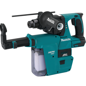

Makita XRH01ZVX drilled 16 holes on a 5-Ah battery or 0.31 Ah per hole. This ships without batteries or charger, though it does include the dust-extractor attachment; online there are deals that include batteries. The HEPA filter case is clear and the maximum hole-cutting capacity is 1 inch in concrete. The drill and dust extractor come with a bag for storage. The drill has a built-in clutch to disengage gears when the bit binds.
While Makita uses a “Sequential Impact Timing” to minimize overlapping bit impacts and claims it results in 50% faster drilling, we didn’t notice any difference.
The kit, which comes with and fits in a canvas bag, retails for $399. Add two 5-Ah batteries ($159) and a charger ($90): All-in cost is $650.

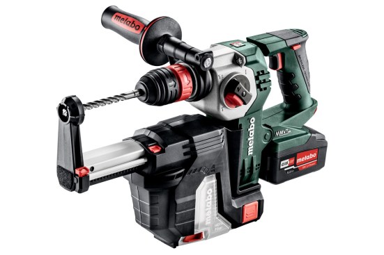

Metabo KHA 18 LTX BL 24 drilled 18 holes on a 7.0-Ah battery or 0.38 Ah per hole. The drill, two batteries, charger and dust extractor will fit in the plastic case. The dust extractor has a clear box for the filter. It comes with a “fast drill chuck exchange for working with SDS+ or straight shank drill bits.”
Kit with tool, vacuum, two 5.2-Ah batteries, charger, and case $599
Specs:
No Load Speed: 0-1,200 rpm
Impact Rate: 0-4,500 bpm
Impact Energy: 2.2 Joules

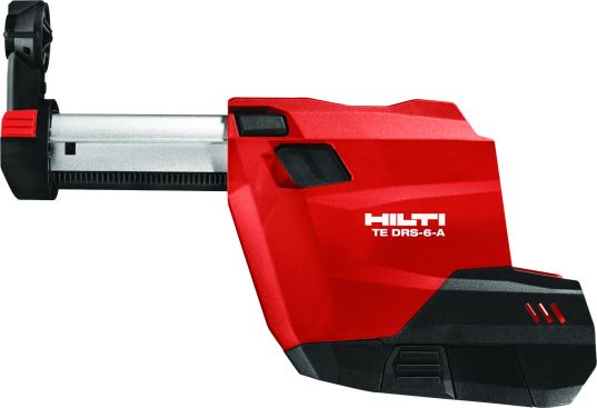

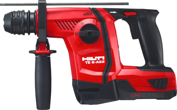

Hilti TE6-A22 + TE DRS 6 -AT1-BA drilled 31 holes on a 5.2-Ah battery or 0.17 Ah per hole. This tool wore me out because it just kept going. The drill, two batteries, charger, and dust extractor fit into the carrying bag. The filter cartridge for the Hilti is opaque, so there is no telling how full it is. What I noticed drilling 1/4-inch holes for split drive anchors is that the dust extraction stopped working after fewer holes than the other tools. This is because the cartridge is smaller, so I had to empty it more often.
Hilti kit: $849 Includes: rotary hammer drill, two 22V 5.2-Ah batteries, dust extractor attachment, charger, 1/4-inch-by-6-inch bit, 3/8-inch-by-6-inch bit, 1/2-inch-by-6-inch bit, five filter cartridges, and carrying bag.
