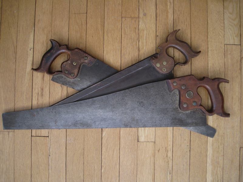

The blades on vintage saws were handmade and taper ground on 4-foot-diameter grinding stones. Taper grinding means the blades are thicker on the edge with the teeth and thinner toward the top of the blades. “A taper-ground blade won’t bind in the kerf you’ve cut,” Cianci says. “That means the teeth don’t need as much set as those on a modern saw.” Lots of set means the saw cuts a wider kerf, which is necessary so the untapered blade won’t bind. But a wider kerf means the blade is more difficult to control when cutting to an exact line.
Vintage saw handles, known at totes, are things of ergonomic beauty. “They were made one at a time, usually from a hardwood like apple,” Cianci says. “Individually shaped by hand. Very comfortable to hold.” It’s better than fit-like-a-glove and more like shaking hands with your best friend.
Modern handsaw blades are sharpened by high-speed, electric grinding machines. “Machine sharpening ruins the steel’s temper,” Cianci says. “Then they can’t be resharpened once they get dull.” Another throw-away tool. He sharpens blades by hand with files.
On his robust website, thesawwright.com, Cianci lists his sharpening services. He also gives sharpening classes and, on occasion, lists restored saws for sale. If you want to buy a vintage handsaw elsewhere, every third or fourth tag sale probably has one. Minor rust can be removed with steel wool and oil. Avoid blades with rust pits that are more than surface deep and check for a loose or cracked tote with broken horns. There’s a chance that a previous owner carved his initials or stamped his name on the tote—a sure sign that someone else recognized the fineness, beauty, and precision of the tool.
