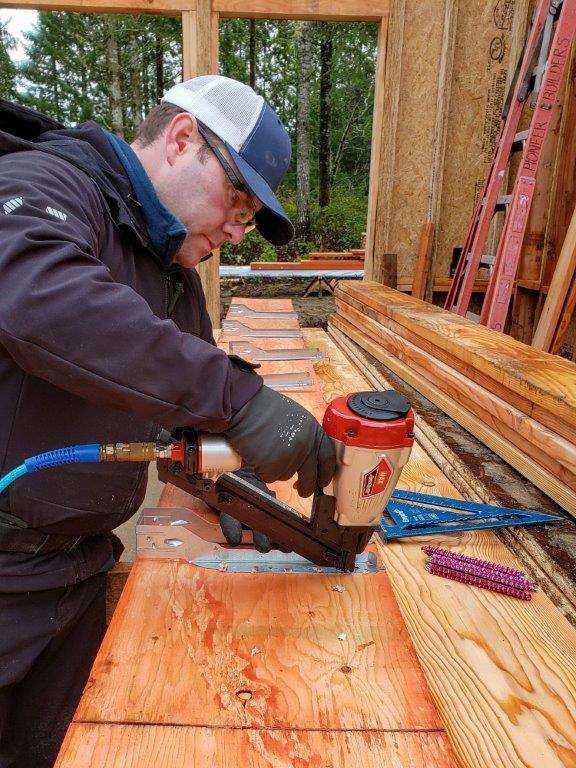

From joist hangers to strapping, to A35 framing angles and other seismic connectors, my company shoots on a lot of metal hardware, so positive placement nailers are invaluable on our job sites. Last fall, Max USA sent us its new SN438J SuperLocator positive placement nailer (which I had first seen at last year’s International Builders’ Show) to try out.

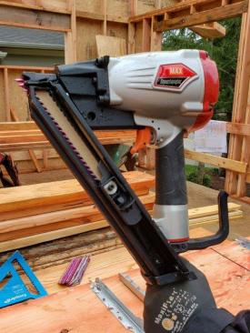

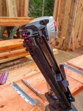

This is a lightweight, compact nail gun with a purposely short, straight magazine to allow it to squeeze into small places. It comes with a plastic belt hook that swivels, and it has a fully-adjustable exhaust cap, a useful feature when you’re working in tight quarters. The gun shoots only 1 1/2-inch-long metal connector nails, but in 0.131-inch and 0.148-inch diameters. Instead of using a probe to locate the hole in hardware, this gun uses the tip of the nail to find the hole, which I think is more accurate.
The Max SuperLocator positive placement nailer has a straight, compact magazine that holds 1 1/2-inch metal connector nails.
Instead of a probe, the gun uses the tip of the nail to locate the hole in the hardware.
