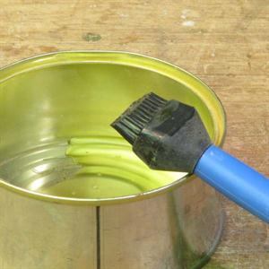

The tool consists of a plastic handle with a flat spatula-like spreader on one end and silicone bristles on the other. The bristles are about 1/16″ in diameter and very rubbery. Glue doesn’t stick very well to silicone, so if it dries on the bristles, it’s supposed to be easy to peel it off.
I’ve had one of these brushes since last summer and have been using it to spread yellow glue, polyurethane, and epoxy. It’s convenient to have a glue brush that can be reused and does not have to be cleaned after each use.
The silicone bristles hold a reasonable amount of glue and are stiff enough to spread it as thick or thin as necessary. If the glue is particularly viscous or needs be spread where the bristle end won’t fit (it’s about 3/4″ thick), you can spread it with the flat end of the tool.

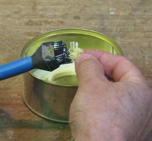

Carpenter’s wood glue can be removed from the bristles by soaking them in water or peeling the glue off after it dries. Dried glue comes off easily — usually in a single piece. Unless you’re willing to use some gnarly solvents, it’s best to wait for epoxy and polyurethane to cure and then peel them off later. These glues have more grab than yellow glue, but if you pull hard enough they will come off the bristles.

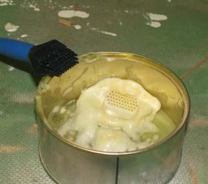

As an experiment, I allowed Gorilla Glue (a brand of polyurethane) to cure into a large blob around the bristles. I had to pull so hard to get them out I was sure some of them would break. None did, but they left their impression in the glue.
