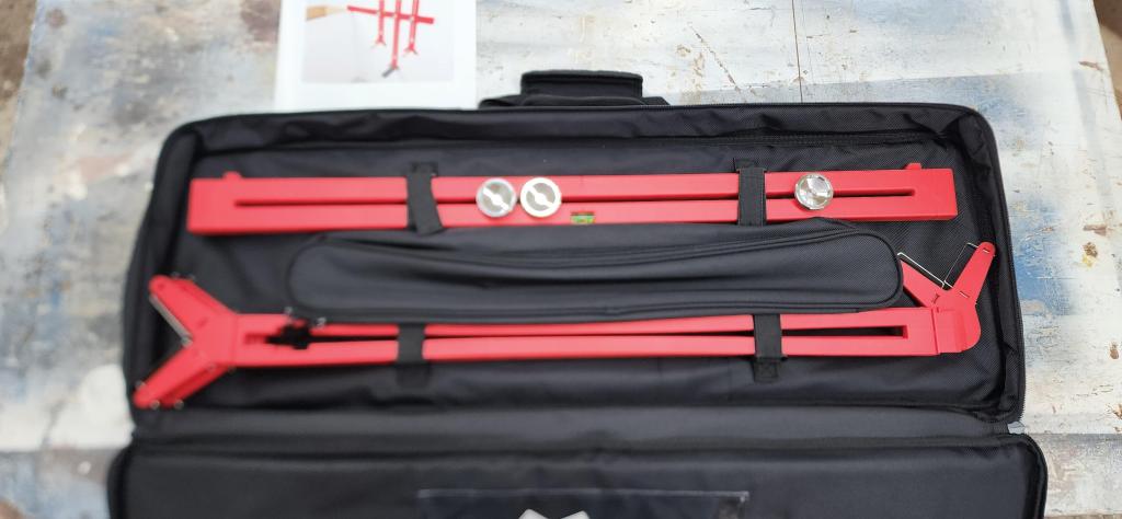

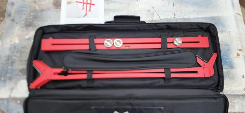

The True Position cabinet jig comes with a padded, zippered storage bag.

Upon receiving the jig, I was impressed by its zippered and padded bag with hold-down straps that secure it during transport. It also came with a full-color, step-by-step instruction booklet. It’s an indication of the quality of a tool when a company puts this kind of effort into creating a storage bag and ensuring you use the tool correctly.

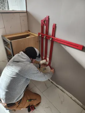

Before using the jig, we first mark a level line on the wall at the sink cabinet’s height and lay out its centerline. We then line up the jig’s center mark with the centerline on the wall and place two fasteners on either side of the line to hold the top bar of the jig level and steady. Next, we line up the jig’s arms (it has three) above each of the plumbing pipes coming out of the wall and tighten the arms using the jig’s stainless-steel knobs.

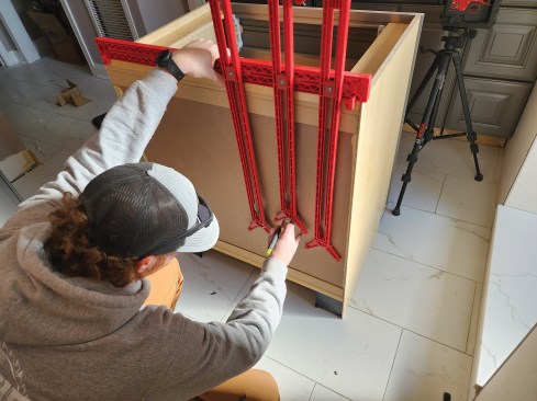

The next step is to mark a centerline on the back of the sink cabinet and line it up with the jig’s center mark, using the stops to keep it in place. Then we trace along the red marking edge of the V-shaped fixed head at the end of each arm to create marks for lining up the edges of a hole saw. It is that simple to mark precise plumbing locations on the back of the cabinet with this jig.
With the Cabinet Plumbing Jig leveled and centered on the cabinet layout, a worker aligns the arms with the pipes (right). After tightening the arms in place, he moves the jig to the back of the cabinet to mark out the pipe locations (above).
With the Cabinet Plumbing Jig leveled and centered on the cabinet layout, a worker aligns the arms with the pipes (left). After tightening the arms in place, he moves the jig to the back of the cabinet to mark out the pipe locations (above).
