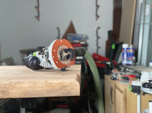

Full-size and mid-size routers offer the most power and versatility, but compact routers—which come in both corded and cordless versions—are capable of most tasks on both the jobsite and in the workshop. Whenever using a router, the author wears safety glasses and ear buds that also provide hearing protection.
I use my trim router for smaller mortises and general template work because it’s easy to control, which also makes it a perfect entry-level router. I like to use it with smaller bits, like a 1/8-inch-diameter round-over where I can just set the bit height and get to work.

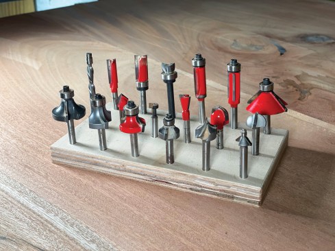

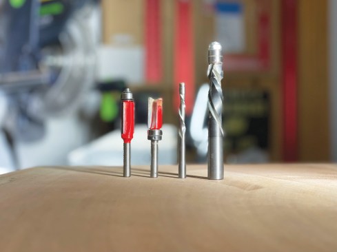

Most router bits are available with 1/4-inch shanks, a size that fits most routers. Bits with a 1/2-inch-diameter shank are better able to withstand the stress and torque produced by the more powerful routers and can plunge deeper into material without the risk of the shank bending or snapping.
Trim routers typically have 1/4-inch spindles, and can only use router bits with 1/4-inch shanks; many mid-size and full-size routers come with both 1/4-inch and 1/2-inch collets and can use both 1/4- and 1/2-inch-shank bits.

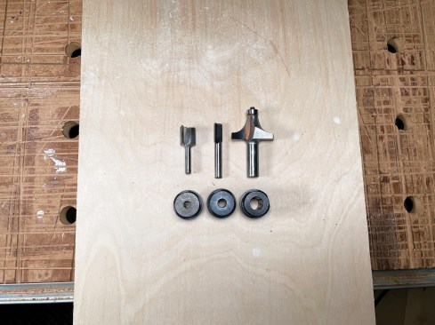

You don’t need to spend a ton of money to get started. Buy router bits as you need them and avoid the large “bargain box” of router bits, as you will probably never use many of them. A variety of straight cut, round-over, and flush trim bits and a 45-degree chamfer bit will get you through most projects. If you find yourself using a particular router bit frequently, spend a little extra coin on the higher-end carbide versions. These higher-end bits will result in a better cut and last longer.
When purchasing bits, the author recommends buying them as they are needed rather than in a boxed set, which might contain bits you’ll never use.
In addition to 1/4-inch and 1/2-inch collets, some routers include a third collet size—8mm—to accommodate 8mm bits offered by some European manufacturers.

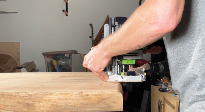

Profiles. Routing a profile on the edge of a board is an easy technique commonly used in both finish carpentry and furniture making. Examples include rounding over the front edge of a shelf or cutting a top profile on baseboard. To guide the cut and ensure that the profile is uniform throughout the entire workpiece, I prefer to use profile bits equipped with a bottom-mounted bearing. Before making the cut, I make sure the edge of the workpiece is smooth and free of bumps or voids—by running sandpaper along it, for instance—as the router bearing will follow this surface exactly. When removing a lot of stock or using large profile bits, take several passes, adjusting the height lower after each pass, to help prevent burn marks or tear out.
Before cutting an edge profile with a router bit fitted with a bottom-mount bearing, the author sands the edge of the workpiece to ensure that the bearing has a smooth surface to follow.
When a profiling bit reaches the end of the material, it can “fall off,” which can distort the profile. To prevent this, add a scrap piece of wood, of the same thickness as the workpiece, at the end. While routing extra material is an easy method, it isn’t always an option.

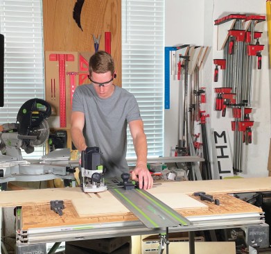

Dados and rabbets. Commonly used in cabinetry, furniture, and door making, these cuts are fantastic for making strong joints. I often use dados to support shelving, not only because they provide plenty of strength to support the weight of the shelf but also because locking the ends of the shelving into dados cut into the shelf supports helps prevent the wood from cupping.
To maximize strength, a dado joint requires a snug fit. For optimum strength, the width of a dado must be just a few thousandths of an inch greater than the mating piece. An easy way to achieve this result is by using dedicated cabinetry straight cut router bits called “undersized dado bits”.

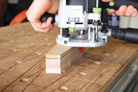

To ensure a snug fit when cutting dados in shelf supports, the author uses a slightly undersized straight cut router bit and guides the router with a Festool guide stop and track.
A few other techniques and jigs can be used when making dado or rabbet cuts, but my preferred method is using Festool’s guide rail and guide stop (model 492601). I find this method to be very safe, as I can clamp the guide rail to the workpiece and keep a hand on the router and guide stop.

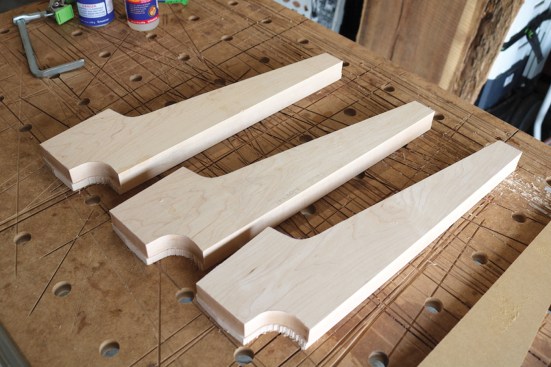

Template routing. Pattern templates are commonly used in furniture making to precisely replicate pieces without sacrificing production speed; they are a great alternative if you don’t have access to a CNC machine. A template is typically made from scrap wood or MDF and then placed either over or under the workpiece. Then, with either a top- or bottom-bearing flush trim router bit, you can follow the template exactly, allowing you to make identical pieces.
To make duplicate table-top supports, the author first makes a pattern, using it to trace the support’s outline on the workpiece, which he cuts out with a band saw. Then he uses double-sided tape to attach the pattern to the workpiece and finishes cutting it out with a flush trim bit that has a top-mount bearing.
After making the initial cut, the pattern can be removed from the stock and the cut can be completed using the same flush trim bit.

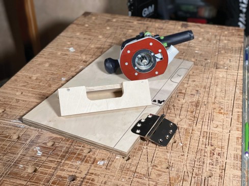

Templates are also great for mounting door hardware, especially when that entails mortising flush-mount pocket door pulls. The template helps me to accurately place the mortise, while it gives me fast and consistent results, along with less chance of making a mistake. On the jobsite (or in the shop), a door hinge template allows you to make precise shallow mortises for hinges on doors, as well as for locks. These kinds of templates have saved me hours of time.
For cutting mortises for door hinges, the author uses a simple plywood template that he fastens to the workpiece with double-sided tape.
The template is sized to fit the hinge template router bit, which typically has a short cutter-to-bearing distance since most hinges aren’t very deep.

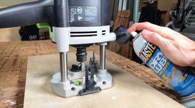

I like to keep my routers running like well-oiled machines, literally. The router has a few moving parts, such as the spindle, and on the larger plunging routers, plunge tubes. A quick spray of white dry lube can keep these parts moving swiftly without sawdust sticking to them like it does to traditional oil lubricants. Any overspray can be easily wiped off with a rag once dry.
An occasional spray with a dry lubricant will prevent the tubes on a plunge router from gathering sawdust and sticking.
