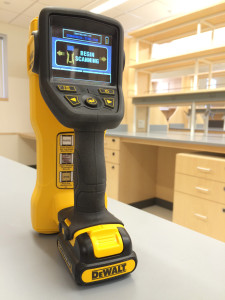

The DCT419 is an affordable scanner capable of detecting and distinguishing between various items found in walls. It can find wood (studs and blocking), non-ferrous metals (such as copper pipes, aluminum, and de-energized wire), plastic (such as PVC, electrical boxes and low voltage wire) and ferrous metals (such as steel studs, cast pipes, nail plates & screws). It can also determine whether or not the wire it finds is live.
Tools of the Trade wanted to test the new scanner so they came to me, because my company specializes in the installation of millwork and cabinets. We do a lot of work in hospitals and commercial environments where there are more than the usual number of things you don’t want to hit hidden in walls. Over the years we’ve installed thousands of cabinets, and during that time we’ve hit our share of water lines and one C02 line I know of.
The tool arrived at the beginning of February and we’ve been using it for over a month. The DCT419 will scan up to 9.8 feet across a wall through drywall, plywood, OSB, tile, and even concrete—to a maximum depth of 3 inches. I’ve had success using to scan through a combination of surfaces such drywall/plywood, tile/plywood, tile/drywall, and wood lath plaster.
This was actually my second time testing a DeWalt scanner. The first was with an earlier model (DCT418) that was pulled when this model (DCT419) came out at the beginning of 2015. They look like the same tool but they’re not. The hardware is more or less the same but the new model has a better software interface, is more user-friendly, and does a much better job distinguishing between materials.
The DCT419 works well but it’s important to understand it’s not like Superman’s X-ray vision; it doesn’t allow you to see through the wall. It tells you the type of materials hidden inside a wall, and it’s up to you based on your experience and what you know of the wall to decide what those materials are. The scanner might tell you there’s ferrous metal behind the drywall; you have to decide if it’s a nail or screw, electrical conduit, black pipe, or something else. Ditto for plastic—which could be a drain pipe, Romex, PEX pipe, or something else made from plastic.

Turn the scanner on and set it to the construction type: wood stud, steel stud, or concrete. Setting the tool to these types does not limit you to scanning those materials; it just allows for a more accurate pre-map scan.
Pre-scan by sliding the unit across the wall in one direction (without lifting it off the surface). The scanner will let you know if you go too fast or slow. During the pre-scan the computer “figures out” what’s wall, what’s wall with something behind it, and what that something is.
At the end of the pre-scan reverse direction and slide the unit (it rolls on wheels) back across the wall. As you move the unit, graphical images representing the material behind the wall at that location will appear on the color LCD screen. It’s important to perform multiple scans at different heights because we’ve all encountered pipes, wires, and ductwork that does not run the full height of the wall. You may miss these items if you only scan at one elevation.
