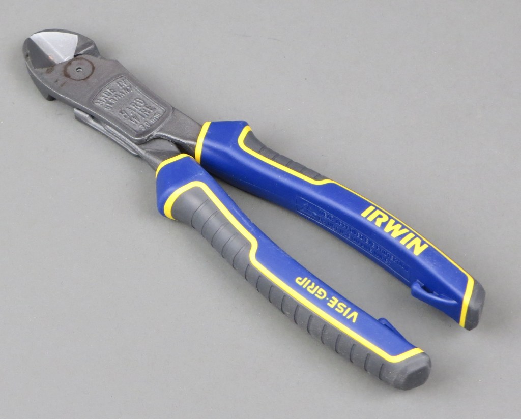

Last week the FedEx guy showed up with an unexpected delivery from Irwin. The box contained a hand tool plus the kind of plastic case a technician might use. Curious to know what was inside I ignored the tool and looked for the combination to the cable lock that held the case shut. No luck; it wasn’t written anywhere. Turning my attention to the tool I suddenly realized how I was expected to open the case; the tool was Irwin’s Vice-Grip Max Leverage Diagonal Cutting Pliers, which use compound cutting action to greatly reduce the amount of force required for cutting. They cut through the steel lock cable with no more effort than takes to cut a 14-gauge copper ground wire with regular wire cutters.
I was impressed by the tool’s ability to cut steel cable until I cut the same material again with the kind of small diagonal pliers an electronic tech might use. They cut it easily, which made me think the cable was not so tough. So I decided to try something harder and test the Irwin tool against some of the other cutters I had in the shop: 8-inch Milwaukee (48-22-4108) diagonal pliers, 7-inch Channellock (337) diagonal pliers, and 7-inch NWS combination pliers (109-49-180). It was not an apples-to-apples comparison because some tools were smaller and the Irwins were the only compound model.
The first thing I cut were 16d galvanized finish nails. The 8-inch tools cut them one-handed; the 7-inch tools required two hands. Next I cut #8 gold drywall screws; only the Max Leverage Pliers cut them one-handed (video below). If there is something to be learned from the test, it’s that it’s easier on your hand and muscles to use compound cut pliers, such as Irwin’s, when making difficult cuts or making heavy cuts all day long.
Unlike bolt cutters and some less-expensive compound cutters, the Max Leverage Pliers contain a minimal number of parts. They are cleanly machined, have comfortable molded grips, and are no bigger or heavier than any other 8-inch diagonal cut pliers. But their compound action means they cut more easily. The grips are equipped with loops to which a lanyard can be connected to prevent them from falling.
