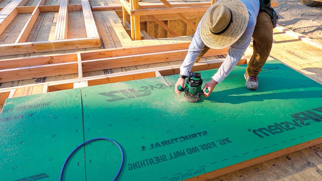

Router for framing? I began using a router to cut out door and window openings, trim the top edges of rake walls, and perform a number of other sheathing-related tasks back in 2001. In order to quickly plow through 7/16-inch sheathing, I fitted my workhorse corded 3 1/4-inch HP router with a big flush-cutting bit with a 1/2-inch-diameter shaft. This was a heavy setup, but it did the job and supported its own weight.

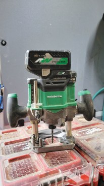

First cordless plunge router. Unlike the DeWalt and Milwaukee routers, however, Metabo HPT’s 36-volt router is a full-featured plunge router that comes with collets for both 1/4-inch and 1/2-inch bits. It has a tool-less depth adjustment that works like that on any other plunge router, a variable speed control from 11,000 to 25,000 rpm, and a handy LED work light. In addition, it’s compatible with Metabo’s adapter (sold separately) that allows HPT tools on the MultiVolt 36V battery platform to be plugged in to a standard AC outlet and used as a corded tool.
A router fitted with a flush-cutting bit makes quick work of cutting out door and window openings in a sheathed wall (see photo at top of page). Metabo HPT’s MultiVolt plunge router comes with collets for both 1/2‑inch- and 1/4-inch-diameter bits. It can be powered by its 36‑volt battery or be used with an adapter and plugged into an AC outlet.
I use a spiral cutting 1/4-inch bit to rout sheathing, and that bit is fast. This router is very fast, too, but if you push it too hard, a protective circuit will cut off power, and it’ll stop. So we’ve learned to back off and let the bit do the work.
What I especially like about this tool is the two handles, making it more comfortable than a smaller cordless trim router for a framer to use. For shop work, the kit includes a template guide set, straight guide, and a dust collector; I won’t use these accessories often, but they are in the bag for when I need them. A charger and one 2.5-Ah MultiVolt battery are also included. I found that I ran this battery down more quickly than the larger-capacity batteries I use on my Milwaukee and DeWalt trim routers, but I still managed to get through a full day of framing without the battery dying.
