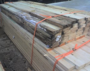

This bundle of studs was delivered to my jobsite a few years ago. I’m assuming this bundle was wrapped in plastic at the lumberyard.
Q: What happens to a 2×4 stud when it gets wet?
A: It dries.
Q: What happens if that 2×4 is wrapped in plastic after it gets wet?
A: It doesn’t dry.
Q: What happens to a wet 2×4 that can’t dry?
A: It grows mold and rots.
Q: What happens to the typical American house that’s built in a four- to six-month cycle?
A: The moisture in the framing lumber dries after a few months of heating and cooling, and the house “settles.” This is normal, but it doesn’t need to be pronounced.
