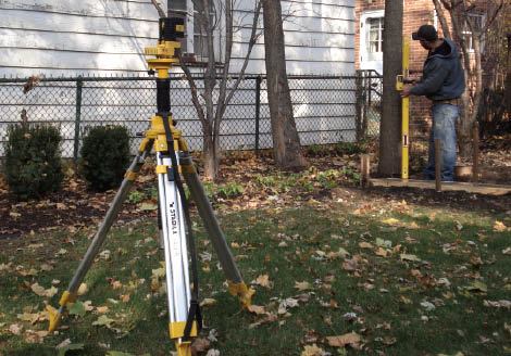

Mounting. Like a transit, lasers work best placed on a firm base such as a tripod. A few tools came with folding mini-tripods. While these worked okay for limited applications, a full-size tripod is a worthwhile investment for tools that will see a fair amount of exterior use.
A good tripod allows you to set up the tool secure in the knowledge the setting won’t change. An even better option is to use an elevator tripod, which provides the ability to raise and lower the tool while it’s attached to the tripod. All the lasers I tested can be used on a standard thread (5/8 inch by 11) tripod, although some require an adapter.
