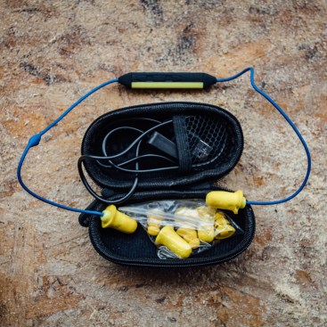

The PlugFones Liberte come with replaceable earplug tips of varying sizes and styles, as well as a case and charger. They sell for $99 online and are available in yellow/blue (shown here), gray/black and orange/blue.
