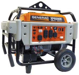

The high-end generator shown at top has full-panel GFCI protection, a voltage selector, and auto throttle (idle) control. The voltage selector allows the user to maximize power to the 120-volt receptacles by switching off the 240-volt circuit. Idle control cuts fuel consumption and noise by reducing the speed of the motor when there is no demand for power. On the modestly equipped machine above, the duplex receptacles are GFCI-protected but the twist-lock receptacles are not; an hour meter allows the owner to track usage so that he knows when it's time to change oil.

Most pro-grade generators have one 240-volt twist receptacle, four 120-volt duplex receptacles, and one or two 120-volt twist receptacles. Some have voltage selector switches, which allow you to turn off the 240-volt receptacle when you are not using it so that the total generator output is available to the 120-volt receptacles.

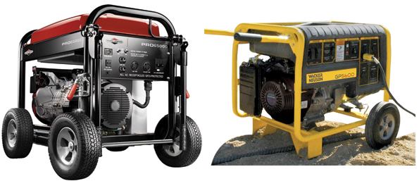

In my opinion, there are two kinds of portable generators: ones that include wheel kits and ones that come with potential back injuries. A 6,000-watt generator can weigh more than 250 pounds. Personally I wouldn't consider buying a unit that didn't roll.
Tires can be solid, semi-solid, or pneumatic. Pneumatic tires have the best bounce and will get you over bumps with the least effort, but they can be punctured and go flat. Solid tires are good on smooth surfaces only. Semisolid wheels are a reasonable compromise; they have some bounce and they won't go flat.
If you plan to hoist the generator with a boom or forklift, look for a model with a lifting hook.
Wheel kits are worth the extra expense because rolling a generator is a lot easier than carrying it. Four wheels are fine for use on smooth, flat surfaces, but two wheels (right) are better on rough terrain. The four-wheel model at left has folding handles that make it possible to lift one end of the unit and roll it like a wheelbarrow.
