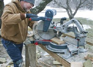

I needed another miter saw like my dog needs another chew toy. I have three chop saws already, and they take up more than their share of room. But when the Bosch GCM12SD showed up, I had to give it a whirl – I love big miter saws. Anything that a smaller saw can do, a 12-inch slide compound saw can do as well, and it’ll crosscut a 2×12 to boot. (Strictly speaking, the GCM12SD isn’t a slider, but it does the same things and competes in the slider market.)
The downside of big miter saws is obvious – their size makes them unwieldy. I hate carrying them from the truck to the job. The GCM12SD weighs in at 65 pounds, which is 6 pounds heavier than my older 12-inch compound saw, Bosch’s 5321. However, the carrying ergonomics of these two saws are completely different. Because of the GCM12SD’s more compact configuration (more on this later), it tucks in close to my body when I’m carrying it, so it feels lighter. I didn’t think this at first – when I initially picked up the saw from the front, it was incredibly awkward. Then I tried carrying the saw from the back – the way the instructions say to. It was night and day. For its size, this is the easiest saw to carry of any I’ve ever had.
The GCM12SD glides back and forth on a set of knuckle joints. While most of the controls are up front on the swing-table handle, there are enough functions that actually reading the manual is a practical necessity. (The photo on the bottom was shot by David Frane.)
Although it cuts like one, this tool works differently from slide compound saws. Instead of sliding back and forth on rails, the GCM12SD’s head moves on a complicated yet robust-looking set of knuckles. It’s unlike anything I’ve ever seen. The knuckles eliminate the rails, which always got in the way and were prone to fouling with dust. And without the rails, this saw takes up almost 1 foot less space front-to-back than my 5321. And talk about smooth! This is hands down the smoothest-operating chop saw I’ve used.
Its capacities are right up there, too. It will crosscut 14 inches of 1-by stock and completely cut through a 2×12 at 90 degrees. Its vertical capacity at the fence is 6 1„2 inches for 1-by stock, and it will handle a vertical 2×6. It won’t cut a 6×6, but 4x4s are no trouble. The GCM12SD miters 60 degrees right and 52 degrees left, and it bevels 48 degrees in either direction.
All the controls are up front, which I like. However, there are a lot of them, and which lever or knob does what wasn’t intuitive – I had to read the instructions. Once I got past that little glitch, it was clear to me that Bosch has a winner here. – Andy Engel
