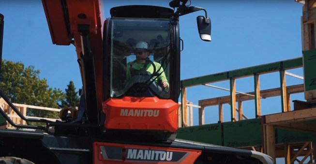

Here, Morton is operating a Manitou MRT 2260 Vision+, one of the two Manitou rotating telehandlers that his company owns. Though he’s in the machine’s cab here, most of the time he works outside thanks to the this telehandler’s remote control functionality.

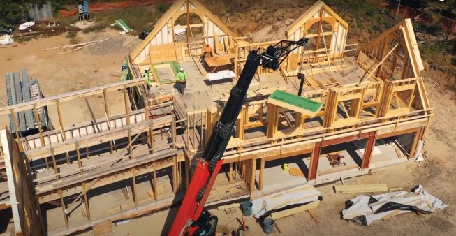

Morton likes to break a project down into the largest liftable pieces possible, then assemble them with the help of a telehandler to avoid working off of ladders. On a large, complex project like this one, having what you need on site when you need it—see Rule #3—is critical in keeping the job moving.
