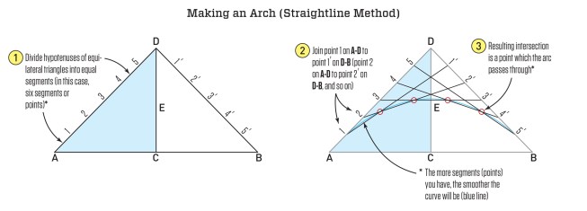

We can build on the use of a scale to divide the baselines (AD and DB) of two equilateral triangles (ADC and DCB). By snapping chalk lines between 1 and 1', 2 and 2', 3 and 3', etc., we can define the arc of a circle for a regular arch. As indicated, the more segments you define, the smoother the curve will be.

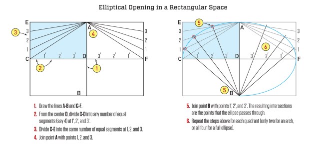

The easiest way to draw an ellipse is with the "pins and string" method (https://mathopenref.com/constellipse1.html). But this method can get unwieldy for large areas, on a vertical wall, or with masonry units. The method shown here, which relies on dividing lines on a rectangular area, might serve as an alternative layout method.

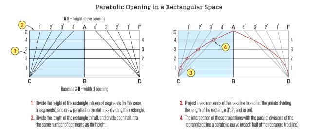

True gothic arches can get pretty complex, but a decent representation can be defined in a rectangular area, where CD defines the arch span and AB defines the arch height. By dividing the sides of the rectangle in even increments (as always, the more increments, the smoother the curve), two intersecting parabolic curves can be defined to form the archway. (Please note: This arch differs from a single parabolic curve, such as the Gateway Arch in St. Louis. That sort of arch can be drawn using a similar method that relies on divisions of the sides of a triangle, as demonstrated here.)

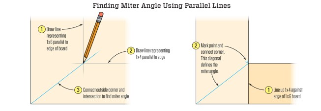

Angles are fundamental to joinery. Most of the time, we are dealing with right angles (90 degrees) and regular miters (45 degrees). What happens when we encounter other angles? Our inclination is to measure that angle in degrees somehow (with an electronic angle finder or a protractor, for example) because the table on a miter saw is set up with degree adjustments. However, a lot of times we don’t need to know the numbers. The miter for joining boards of unequal width, for example, is an acute angle less than 45 degrees, which we can lay out using parallel lines, as shown below. Once we understand this idea, we can just measure the width of one meeting board off the end of the other and join the diagonal.
Click to enlarge image below.
Or we can lay out any angle using a compass and a straightedge to bisect the angle as shown below.
If we do this on a scrap piece of wood, we can cut the angle we’ve drawn by aligning it with the blade on our miter saw—no numbers needed.

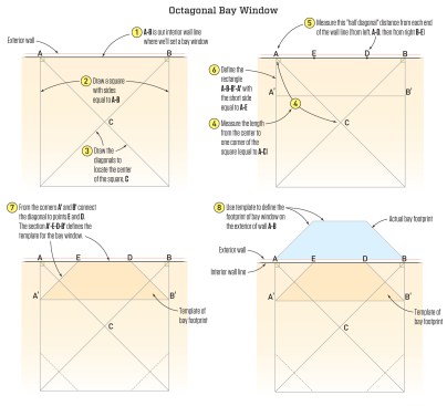

To lay out an octagonal bay window, you can work from inside the house or outside. In this set of illustrations, we are laying out a template on the interior. We start with what we know: the base of the octagonal section on the exterior wall, line AB. Inside the room, define a square with sides equal to AB, and define the diagonals to identify the center point C. Using the length of AC, measure from point A to define point D, and measure from B to define the point E. We can then measure AE, to define the distance AA' - the distance that the bay will project from the exterior wall. The measurements can be used to create a template of the bay window's footprint, or you can use a square and chalk lines to transfer the measurements to the exterior.

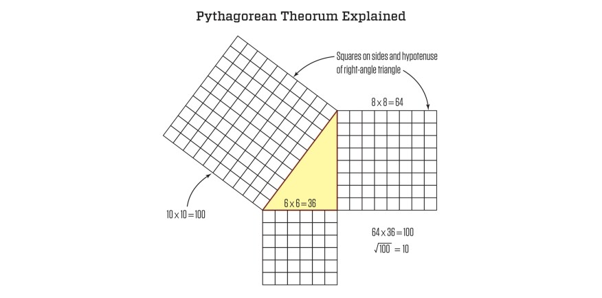

Leveraging the Pythagorean theorem. When we frame roofs or square large areas like a floor frame or lay out plates in preparation to stand walls, we can’t avoid the Pythagorean theorem: a2 + b2 = c2. If the abstract nature of this formula makes you nervous, it may be helpful to see the equation spelled out in geometric form, as shown below. (This visual explanation also gives us a construction of the square root function that maps the area of a square to its side length.)

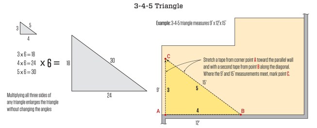

The example shown above is a 6-8-10 right triangle—a larger form of the all-powerful 3-4-5 right triangle; if one leg of a triangle measures 3 and the other 4, we know by the Pythagorean theorem, c = √ (a2 + b2), that the diagonal measurement, c, will be 5. But we don’t have to calculate this. Rather, we can use these dimensions as a check for square for any right angle: By measuring out one side equal to 3 units (inches, feet, anything) and the other side equal to 4 units, we know the hypotenuse connecting these sides will equal 5 units—or any multiple of 3-4-5: 6-8-10, 9-12-15, 12-16-20, and so on. When you’re squaring a floor or a foundation (see example, below), it’s always most accurate to use the largest multiple for the walls that you are laying out. For a more detailed explanation of this layout procedure, see “Framing Square Basics: Foundation Layout” by John Carroll.

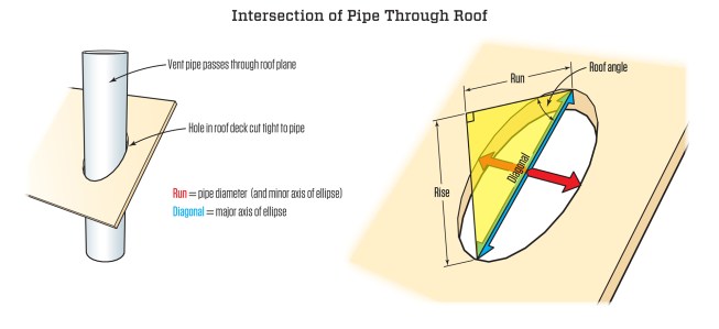

The Pythagorean theorem relates to more than roof framing and right-angle layout; it can also be used to define the ellipse created where a vent pipe passes through a sloped roof. When the roof deck is part of the air barrier, we want to create a hole for the vent that can be tightly sealed.
The width of the hole (defined by the thick red arrow) for a vent pipe through a sloped roof is the minor axis of an ellipse. It's the diameter of the vent pipe and it doesn't change; only the major axis (blue arrow) changes with the roof slope. The length of this diagonal can be solved using the Pythagorean theorem. So, for example, on a roof with a slope of 8/12, we could solve this using the unit run and unit rise: 82 + 122 = 208. The square root of 208 = 14.42, or 14 7/16. However, a vent pipe is unlikely to be a full 12 inches, so we need to reduce the numbers proportionally. For example, with a 3-inch-diameter pipe: 8/12 = x/3, where x = 2. Then solve for the diagonal: 22 + 32 = 13. The square root of 13 = 3.6, or 3 5/8.
Adapted from ThisIsCarpentry; Mike Sloggatt and Gary Katz
