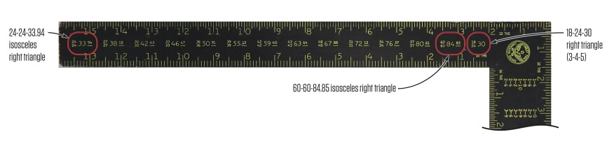

A traditional framing square includes a number of cryptic-looking tables on both the blade (the longer, 2-inch-wide portion of the square) and the tongue (the shorter, 1 1/2-inch-wide portion). The rafter table on the front of the square is easy enough to identify (if not to interpret), while the brace table on the back of the square may seem a little more obscure. These tables can look perplexing at first glance, until you realize that the numbers in both tables describe the base, the altitude, and the hypotenuse of a series of right triangles (see photo, below).
Click to enlarge
A framing square can be used as a ruler, a straightedge, and a right angle, but it also includes a brace table and the Essex board measure table, as well as several different scales on both the front and back (shown) of the square.
A framing square can be used as a ruler, a straightedge, and a right angle. It also includes a brace table and the Essex board measure table, as well as several different scales on both the front and back (shown) of the square.
For a timber framer, the brace table—sometimes called the diagonal scale—is useful for knee or post bracing because it indicates the lengths of the diagonals of isosceles right triangles. It can also be used to cut and fit angled braces to hold things like window and door jambs, cabinets, and shelving square while you install them. Some triangles, such as the 48-48-67.88 triangle, could be doubled to lay out let-in bracing, a required skill before the advent of 4×8 sheathing. These tables have been on squares since the 1830s, when carpenters built windows and cupboards from scratch.
Click to enlarge
The first entry on the far left-hand side of the brace table indicates an isosceles right triangle with two sides that measure 24 (of any unit of measure) and a hypotenuse that measures 33.94 (in the same unit of measure). Each of the following 12 entries is the same triangle but with different dimensions. The final entry on the far right-hand side of the brace table is a basic 3-4-5 right triangle, in this case with sides measuring 18 and 24 and a diagonal of 30.

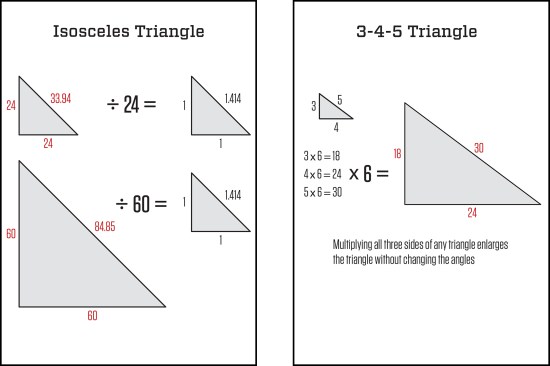

Working the triangles. The first 13 entries on the brace table are actually the same triangle. All are isosceles triangles, which means they have two equal sides. They also have the same angles, which are two 45-degree angles and one 90-degree angle. On every one of the entries, you can reduce the triangle to a 1-1-1.414 triangle by dividing all three sides by the smaller number in the entry.
The last entry on the brace table is 18-24-30. This is a 3-4-5 triangle multiplied by 6. The 3-4-5 triangle is easy to remember, and it fits the rectangular shape of a lot of building elements better than the 1-1-1.414 triangle.
These triangles can be expanded without changing any of the angles by multiplying the lengths of all three sides by the same number. If you multiply all three sides of the familiar 3-4-5 right triangle by the number 8, for example, you end up with a right triangle with sides of 24, 32, and 40. This enlarged triangle retains the exact same angles as the 3-4-5 triangle. This process, by the way, works in reverse: You can shrink any right triangle by dividing all three sides by the same number.
What’s more, you can use these numbers with any measuring unit you want. You might use a right triangle that has an altitude of 24 feet, a base of 32 feet, and a hypotenuse of 40 feet to square up the foundation of a house. Or you could use a right triangle with an altitude of 24 inches, a base of 32 inches, and a hypotenuse of 40 inches to square up a bookcase.
The ratio of the sides of an isosceles right triangle is 1-1-1.414 (left). Reducing the 24-24-33.94 triangle on the brace table by a factor of 24 and the 60-60-84.85 triangle by a factor of 60 produces identical 1-1-1.414 triangles. This pattern holds for all but the last 18-24-30 triangle on the brace table, which is a 3-4-5 right triangle (right). These ratios are commonly used in construction to determine that two layout lines are exactly perpendicular to each other.

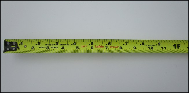

Using an engineer’s scale. For the 24-foot square just described, the critical dimension is the 33.94-foot hypotenuse. You can convert the .94-foot dimension into 11 1/4 inches by multiplying .94 by 12 (this comes to 11.28 inches). But you don’t need to make this conversion mathematically if you have a tape measure marked with the engineer’s scale, where feet are divided into tenths and hundredths rather than inches; simply measure and mark the 33.94-foot dimension using a 100-foot engineer’s tape measure.
Click to enlarge
To lay out a perfectly square foundation with 90-degree corners, use the isosceles right triangle in the brace table that corresponds most closely to the desired dimensions, and set up batter boards and string lines as described in the steps above.
A tape measure laid out in the engineer’s scale is a great time-saving tool, but it is not compatible with inches—even if the inches are divided into tenths. This means that the tenths scale on the framing square should not be used to convert to the engineer’s scale. Here’s why. The engineer’s scale is divided into tenths of a foot, which are further divided into hundredths of a foot. A standard foot, on the other hand, is divided into 12 inches. If the inches are divided into tenths, there are 120 of these increments per foot. At 1/120 foot, these increments are smaller than the 1/100-foot increments in the engineer’s scale.
To lay out foundations, the author uses a tape measure marked with the engineer’s scale, which divides a foot into increments of 100 rather than inches. This tape also has a standard scale marked along the bottom edge.
Once in a while, though, you might want to convert from one scale to the other. If you use math, it’s a two-tiered process. To convert 5 3/4 inches to a decimal foot, for example, start by converting 5 3/4 inches to 5.75 inches, then divide 5.75 by 12 to get to the engineer’s scale equivalent, which is .48 foot. To go from hundredths of a foot to inches, multiply the decimal by 12. In this case, .48 x 12 = 5.76 (5 3/4 inches).
It’s simpler and easier, however, to measure and mark the length of the partial foot in one scale, then remeasure that distance with the other scale. For this reason, 6-foot engineer’s scale rulers have standard inches and fractions on one side and the engineer’s scale on the other. And engineer’s scale tape measures that are 25 to 30 feet long usually have standard feet and inches along one edge and the engineer’s scale along the other.

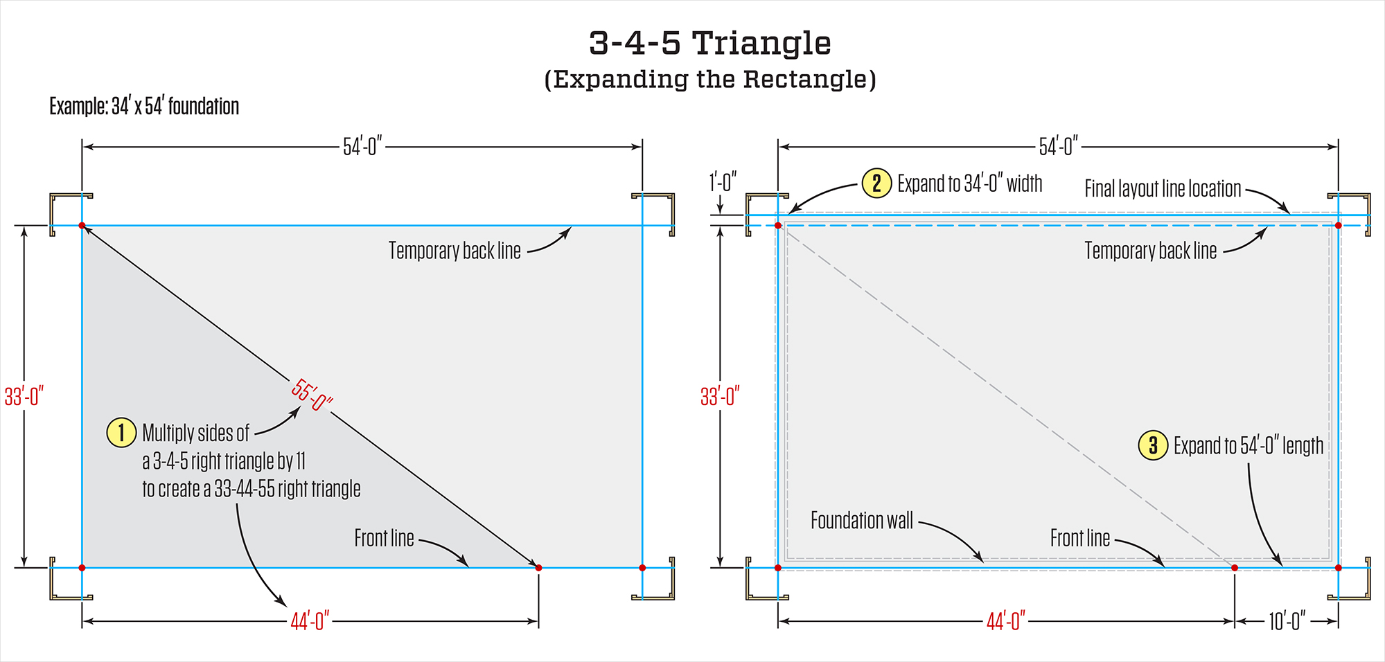

The builder who laid out the foundation for my house in 1949 may have used the final 18-24-30 entry in the brace table for reference, because my house footprint is a rectangle measuring 34 feet wide and 56 feet long. To do this, he could have expanded the 3-4-5 triangle by a factor of 11, then laid out a 33-44-55 triangle. After establishing the perpendicular line, he could have moved the parallel line one foot (see illustration, below).
Or he could have divided 34 by 3 and then multiplied the result, 11.33, by 4 and 5. This would produce a 34-by-45.32-by-56.65-foot triangle. Doing it this way would have required less than five minutes of math, but he wouldn’t have had to move the line after he squared up the foundation.
Click to enlarge
One way to lay out a 34-by-56-foot rectangular foundation is to multiply the sides of a 3-4-5 right triangle by 11 to create a 33‑44-55 right triangle, then expand the rectangle as shown.
Click to enlarge
Alternatively, you can find the dimensions of a triangle with a height of 34 feet by dividing the height by 3 (34/3 = 11.33) and multiplying the other two sides by that result.
