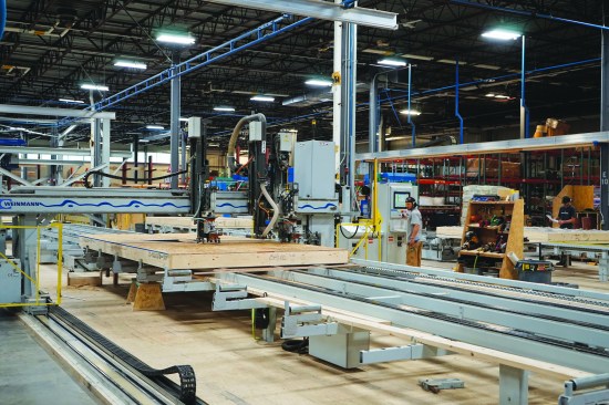

Construction has avoided a complete takeover by scientific management for a number of reasons. For starters, construction doesn’t easily and inexpensively lend itself to a factory environment, where efficiency experts have been most successful at consolidating the decision-making and reducing labor to series of isolated steps. That is not to say construction can’t be translated to the controlled conditions of a factory. The resurgence of interest in what is now dubbed “off-site construction” speaks to the industry’s yearning to improve construction productivity.
Unity Homes is a good example of how offsite building methods can be employed to efficiently build high-performance homes. The state-of-the-art housing factory in Keene, N.H serves a concentrated housing market  extending from Maine to New Jersey. But the intense capital investment needed to set up such a housing plant, makes it unlikely that the entire housing industry  will consolidate around large corporate building solutions that can satisfy the housing demand across all urban and suburban markets.
Ted Cushman

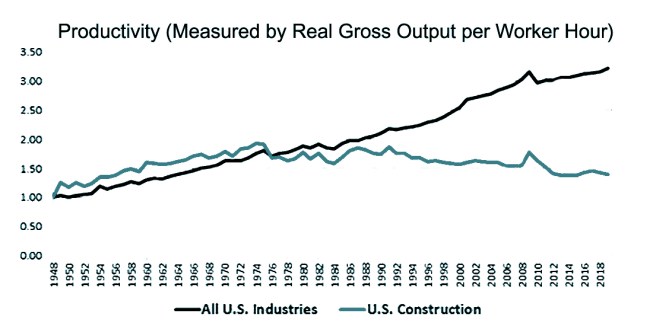

Click to enlarge
Construction productivity began to lag shortly after OSHA formed (1971) and the OPEC oil embargo (1973) raised demand for energy-efficient buildings. Coincidence or cause?
chart data from Jesse Livermore, Philosophical Economics
A look at the timeline showing a comparison of construction with other industries (see chart above) reveals that the lag in construction productivity begins in the 1970s. These figures lump all construction types together, but the pattern and timing hold true for residential construction. I can’t help but notice that the lag begins shortly after 1971 when OSHA forms and just around the time the OPEC oil embargo began to raise demand for more energy-efficient buildings. Brian Potter (whose exceptionally smart newsletter, Construction Physics, recently took up the relationship of construction productivity to construction safety) makes the case that safety requirements have had a greater impact on construction than on other industries, helping to link increased safety with lower construction productivity. He concludes that while certainly part of the story, it hasn’t had as big an impact in residential construction because, in his opinion, not many residential construction workers abide with regulations such as tying off with fall arrest equipment near a leading edge. I have a different experience within the JLC community, where I think there has been increasing interest in providing employees with a safe work environment as an authentic action of care for their well-being. It’s a central tenant of Gerstel’s employee-centered company, which provides the best blueprint I know for attracting and retaining a skilled workforce.
Construction quality and building performance are better drivers of long-term economic strength for housing than measures of productivity.
The correlation of construction productivity to energy-efficient building practices, and to better building standards in general, is a more speculative leap than the safety correlation. It derives from a general premise that construction quality and building performance are better drivers of long-term economic strength for housing than measures of productivity. Houses, or even roads and power plants don’t make good consumables and probably shouldn’t be evaluated by the same economic measures as cars, iPhones, or paper plates.

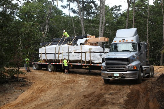

Houses aren’t iPhones or cars. The transportation challenges of moving prefab housing are not to be underestimated. This limitation sharply differentiates housing from manufacturing and wholesale/retail goods, as houses have no value without a site to locate them on. Real-estate professionals know this all too well  -"location, location, location" - while building professionals account for it using a range of critical design variables, including soil bearing characteristics, perc rates, set backs, climate zones, window placements, solar angles and wind exposure. Despite the importance of the site as a productivity input, it is never part of  labor productivity calculations when pundits compare construction to other industries.
Roe Osborn
Houses aren’t iPhones or cars. The transportation challenges of moving prefab housing are not to be underestimated. This limitation sharply differentiates housing from manufacturing and wholesale/retail goods, as houses have no value without a site to locate them on. Real-estate professionals know this all too well "location, location, location" – while building professionals account for it using a range of critical design variables, including soil bearing characteristics, perc rates, set backs, climate zones, window placements, solar angles and wind exposure. Despite the importance of the site as a productivity input, it is never part of labor productivity calculations when pundits compare construction to other industries.
Off-site construction methods continue to be the oft-cited solution for increasing construction productivity and for bringing the construction workforce under the control of scientific management practices, but we have a long way to go before realizing any meaningful change. Since I wrote my article in 2019, off-site methods have backslid to around 2.5% of the 970,000 new homes built in 2021 (by the most recent U.S. Census figures), with the remainder (946,000) being stick built. That’s a huge margin. At the very least, it will be decades before we significantly change the proportion of off-site to stick-built homes. True, the U.S. population is shifting away from rural areas, which make up the majority of U.S. land area. But I think the economics will never pan out to make off-site the majority building practice: Whenever I hear someone say we ought to build houses like cars, I ask them, how many houses fit on a truck? While there is no question off-site methods will play a greater role in concentrated building markets where housing demand is strong enough to justify the intense capital investment needed to set up a housing plant, the industry is unlikely to consolidate around large corporate building solutions that can satisfy the housing demand across all urban and suburban markets. The investment is too steep and the transportation requirements too great. In countries like Sweden, off-site methods comprise 85% of housing. But Sweden has a landmass about the size of California, which makes up only 4.3% of the 3,796,742 square miles that comprise the U.S. landmass.

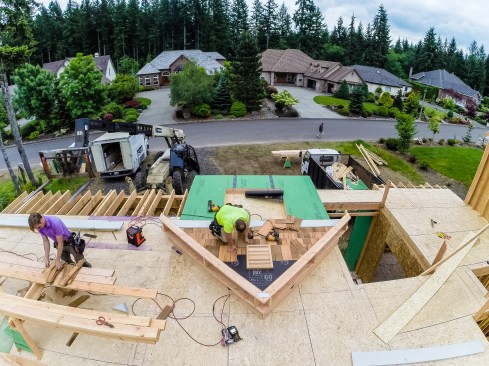

Building faster and safer. Tim Uhler installs the siding, vent, and eaves on rake walls before lifting them in place.
Tim Uhler

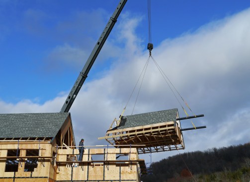

Prefabrication doesn’t always need a factory. Lee McGinley found it safer and more efficient to build this roof assembly on the ground and crane it into place.
Lee McGinley
Technology is playing a meaningful role in improving housing productivity in the form of more sophisticated building components, however. Drywall, window and door units, plywood (then OSB, then Zip System sheathing), trusses, I-joists, structural insulated panels, and insulated concrete forms are all examples that have meaningfully shaved time off the production process.
We have also witnessed homegrown solutions that improve safety and jobsite efficiency like Tim Uhler’s methods of preassembling the eaves and siding on rake walls before standing them (see “Rake Wall Framing,” Sep/14). Lee McGinley realized considerable savings in time and increased safety by prefabricating roof assemblies on site and lifting them into place with a crane (see “How to Safely Frame a Roof on the Ground,” Apr/14). Companies like Davis Frame Co. in Claremont, N.H., and Sprowl Building Components in Searsmont, Maine, have been panelizing walls for more than 30 years. The history of homebuilding has been a continuous evolution of building components and process improvements. So why has productivity essentially been flat for the last 75 years? Precisely because we are building vastly better homes today and killing fewer workers in the process.
