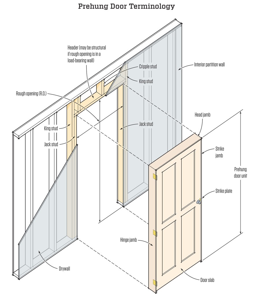

Vocabulary:
Rough opening (RO): Framed opening into which a door or window fits.
Jack studs: Vertical framing members that flank each side of a rough opening and support the header.
King studs: Full height vertical framing members that the jacks attach to.
Header: Horizontal framing member that forms the top of the rough opening. May be structural if the wall with the opening is a supporting wall.
Cross-leggedness: A condition when the two sides of the RO or the assembly are not in the same plane.
Prehung door: An assembly of finished jambs and an operating door that fits into a rough opening.
Hinge jamb: The vertical side of the prehung door assembly that the door is hinged from.
Strike jamb: (Also called the latch jamb) The vertical side of the prehung door assembly that the door closes against.
Head jamb: Horizontal part of the prehung door assembly.
Door stop: Finish trim inside the perimeter of the jamb that door closes against.
Door slab: The operable section of the door.
Reveal: The margin or gap between the door slab and the jambs.
Shim: Tapered piece of wood (usually made from a wooden shingle) that keeps the door assembly positioned in the rough opening.
