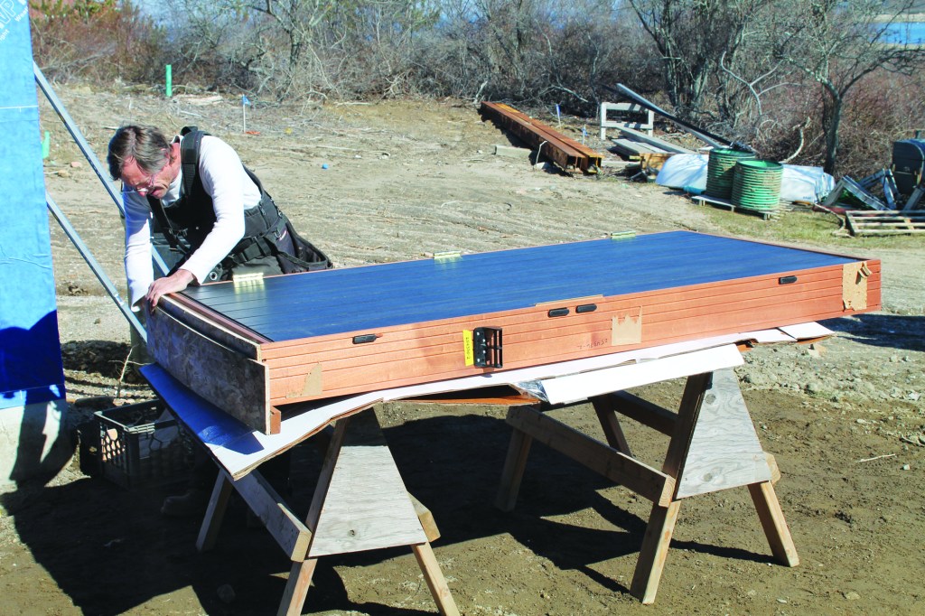

Check the door. When I get the door, I check both the door slab and the preassembled jamb carefully, looking for quality issues from the manufacturer. Prehung exterior doors sometimes come with the trim attached, but I never order precased doors from the factory, preferring to trim my own doors. Preattached molding interferes with adjusting the jambs in and out, and it makes air-sealing the jambs difficult as well.

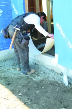

Flash the sill. A traditional approach for flashing a rough sill is to install a metal pan with upturned sides and an interior curb that fits against the finished flooring. But custom pans are expensive and also form a thermal bridge. Adjustable plastic versions are available, but they often don’t work with different sill configurations, and they can crack over time. Instead, I prefer to use flexible self-adhering flashing tape to make durable and effective pans (see “Flashing an Entry Door,” Jan/06).
After flashing the sill with flashing tape ...
After flashing the sill with flashing tape …

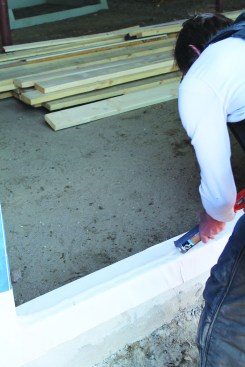

Caulk the sill pan. Some manufactured sills have hollow or recessed areas, so before caulking the sill pan, I check the bottom of the door sill to make sure that I apply the caulk where it will make good contact. I clean and dry the sill pan, and then apply a very heavy bead of silicone caulk across the entire width. I use silicone because it is flexible but cures hard enough to provide some support to the sill, and it can be peeled off years later if the door needs to be replaced. I put additional caulk at the two ends, which are areas prone to leaking. After installing the door, I reach in with a narrow shingle and tool any excess caulk into a sloped dam toward the outside of the pan.

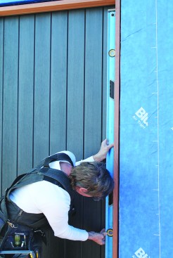

Before securing the bottoms of the jambs, I make sure that there is enough room in the rough opening to plumb the door from side to side. Sometimes it’s necessary to start with the sill closer to one side. Once I’m sure of the placement, I shim and fasten the hinge jamb right behind the bottom hinge.

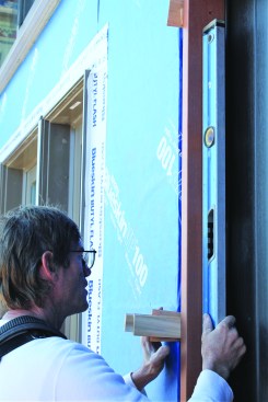

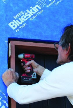

Using the door itself as a guide, I shim the tops of both side jambs until the margin between the door and jamb across the top is perfectly even. If the sill is level, this occurs when the jambs are plumb. I use a level only for double-checking and as a straightedge. As I shim and fasten the door jambs into place, I keep them in plane with the wall so that the exterior casing lies flat. Out-of-plumb walls may need tapered extension jambs for the trim to lie flat. I drive two screws—one in the thick part of the jamb and one in the door rabbet—at each set of shims.

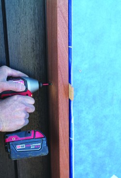

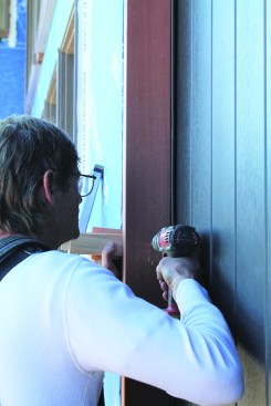

I add shims directly behind each of the hinges and drive long screws (typically provided by the manufacturer) through the hinges and into the framing as soon as I confirm that the jamb is plumb. Without the screws into the framing, the weight of the door tends to flex the jamb and makes it difficult to control the margin on the strike side.
Drill and drive a stainless steel screw to hold the jamb at the top hinge.
Make sure the jamb is straight.

Fasten the top of the strike jamb.
Then straighten ...
Then straighten …

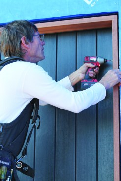

... and fasten the rest of that jamb
… and fasten the rest of that jamb
Attach the strike side. When shimming the strike side, I use the margin between the jamb and the door as a reference. Installing shims very close to the top and bottom lets me straighten both ends of the hinge jamb at the same time by pushing the head jamb and sill over as needed. I shim behind the lockset strike for security and then add more sets of shims as needed to hold the jamb straight. I avoid putting shims and nails where I might need to drill and mortise later for a deadbolt.
Because of the inevitable movement and settling of the framed opening, I never shim between the head jamb and header, so that the jamb stays straight and the door operates properly over time. If I need to hold the head jamb straight, I shim it temporarily, fasten the exterior casing, and then remove the shims with the casing left to hold the jamb straight. Another strategy is driving a couple of 10d galvanized finish nails up through the jamb and using the friction of the nails to hold the jamb straight until I install the trim.
