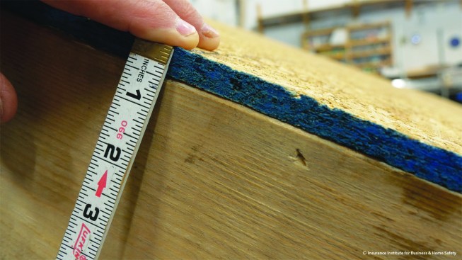

Roof sheathing—either plywood or OSB—should be a minimum of 7/16 inch thick.

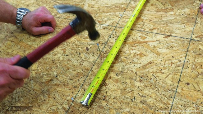

Within 4 feet of the rake, sheathing panels should be nailed to the roof with ring-shank nails spaced 4 inches on-center on the edges and 6 inches on-center in the field. On the rest of the roof, the ring-shank nails should be spaced 6 inches on-center everywhere.
Nailing the Sheathing
Plywood or OSB sheathing should be at least 7/16 inch thick and fastened with 8d ring-shank nails. At panel joints and within 4 feet of the gable end, nails should be spaced 4 inches on-center. On the rest of the roof, nails should be spaced no farther apart than 6 inches on-center. If the building is near the coast and exposed to salt air, fasteners must be corrosion-resistant.

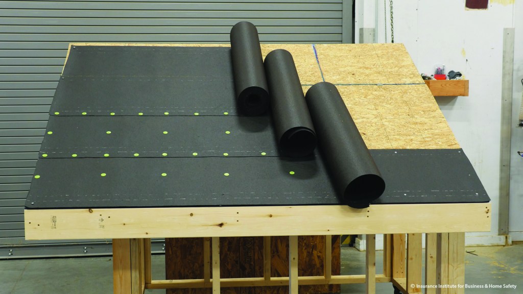

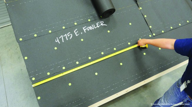

The first method is to cover the roof deck with two courses of #30 asphalt-saturated felt. All asphalt felt is not created equal: IBHS testing has found that some lighter-weight products labeled as #15 and #30 felt will not perform effectively in the face of wind-driven water. So always choose #30 felt that is labeled compliant with industry standards ASTM D226 (Type II) or ASTM D4869 (Type IV).
Fasten the felt to the roof with cap nails, 6 inches on-center at the edges and 12 inches on-center in the field.
The felt comes in 3-foot-wide rolls. Begin with a 19-inch starter course, then apply a full 3-foot course directly over this. Continue shingle-fashion with full 3-foot material, leaving a 17-inch reveal. Fasten with cap nails, spacing the nails 6 inches on-center on the edges and 12 inches on-center in the field. Don’t nail the felt on the roof edge. At this location, drip edge will be nailed over the felt to secure the assembly.

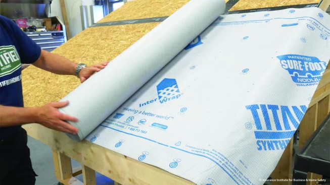

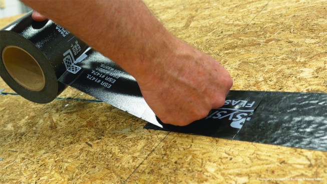

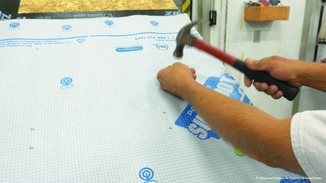

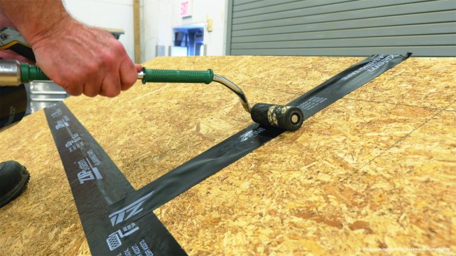

As an alternative to double-coverage felt, the IBHS Fortified program also allows you to protect the deck with single-coverage underlayment (either organic felt or synthetic underlayment). But in that case, you must start by sealing the seams of the roof deck with peel-and-stick tape.
Alternatively, you can seal the sheathing seams using peel-and-stick tape.
And protect the roof using a synthetic roof underlayment, following manufacturer’s instructions.
As with felt, not all tape is the same. If you use a modified-bitumen tape, make sure it meets ASTM D1970. If you use a butyl or acrylic tape, it must meet AAMA 711, Level 3.
Roll the tape with a pressure roller to make sure it’s fully adhered without air gaps or wrinkles.
Once the seams are taped, you can apply either an organic-felt or synthetic underlayment with the overlap and fastener spacing specified by the manufacturer. Always use cap nails to attach the underlayment.

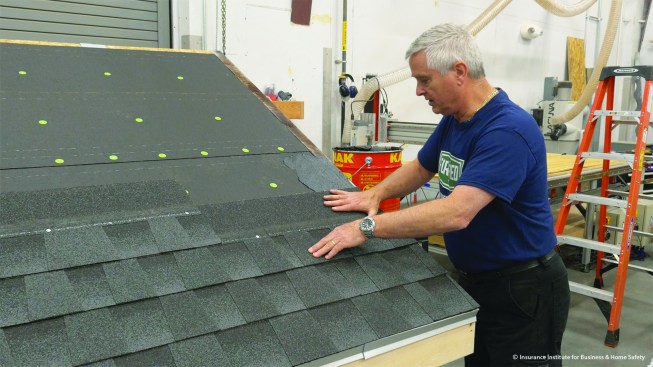

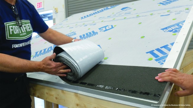

A good weather seal between shingles and underlayment is key to preventing damage in a storm. One approach is to apply a self-adhered manufactured starter strip.
Starter Strips
Many shingle manufacturers now supply starter strip material, either in long rolls or in short, shingle-width pieces. If the starter strips are self-adhered, they meet the IBHS Fortified standard; the peel-and-stick adhesive on the underside of the strips serves to seal the material down to the drip edge, creating a watertight assembly. But you do need to check to find out whether a primer is required for adhering the strips to drip edge, and also whether the strips are compatible with the brand of shingle you’ll be installing.
To install the starter strip, peel off the removable backing and use the adhesive backing to secure the material to the drip edge.

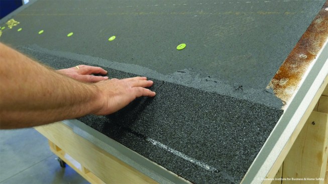

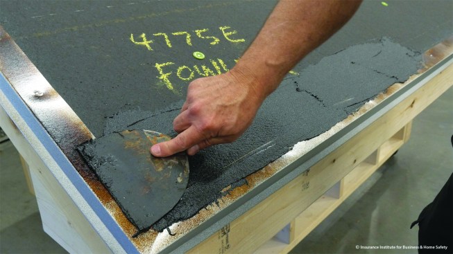

Another option is to embed the starter shingles in a 1/8-inch-thick bed of roof mastic.
Using Roof Mastic
If the starter strip material doesn’t have its own adhesive backing, it needs to be set into a bed of asphaltic roof mastic. Apply the mastic over the drip edge in a bed no more than 1/8 inch thick and 8 inches wide. Set the starter strip into the mastic. You can tack it in place to hold it securely.

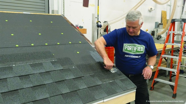

You can use a starter strip on the rake as well as the eaves, but if you prefer, you can set the shingles directly into roof mastic using a method sometimes called “step-bulling.” With this technique, the roofer applies the 1/8-inch bed of roof mastic up the edge of the roof, and then lays the shingles into that bed of mastic. This bonds the shingles to the drip edge.
As you shingle up the roof, add a dab of roof mastic to each shingle before you set the next shingle in place. This helps the shingles resist wind uplift in case of high winds.

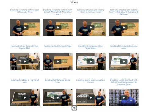

For more Inside FORTIFIED videos, click here.
To help roofers install roof assemblies that meet FORTIFIED requirements, we have developed a series of short, easy to follow videos and one-page “how-to” guides (in English and Spanish) called “Inside FORTIFIED”.
