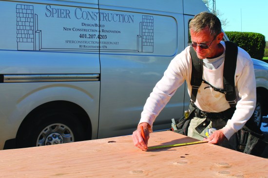

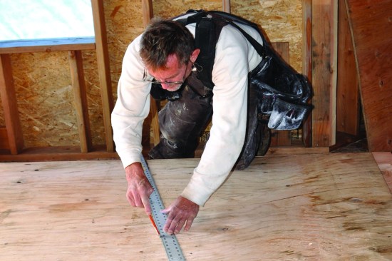

The fastest way to mark sheet goods for cutting is by using a measuring tape with a pencil on the hook end. Move both hands at the same speed for a straight line.

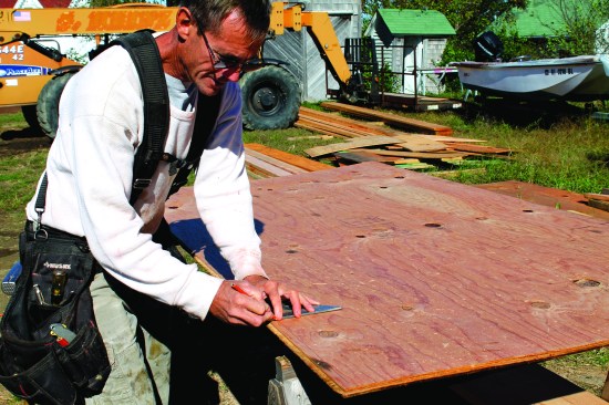

A T-square makes a good straightedge, but with bumpy edges on the sheets, don’t trust it to be square.

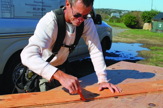

To mark a narrow rip, slide a layout square along the edge while holding a pencil at the measurement.

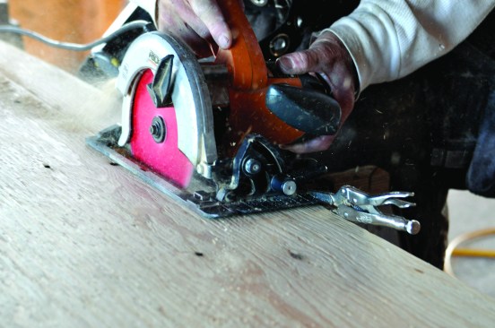

To make a narrow rip without marking a line, clamp locking pliers to the saw table to act as a rip guide.

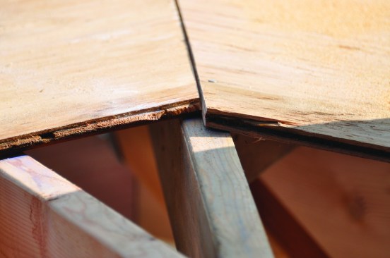

Tongue-and-groove edges can make it difficult  to make efficient use of angled cutoffs,  as when you’re working on roofs.  Alternating tongue up and tongue  down lets you use the same angled  cut on adjacent roof planes.

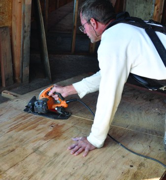

After marking  a cut line, slip a short length of 2-by  under the sheet a couple of inches from  the line. Then you can make your cut  without damaging the sheets below.

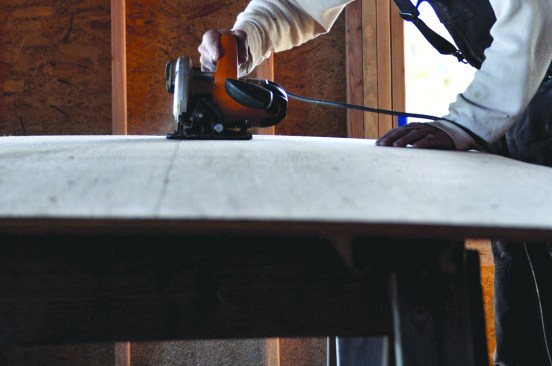

The best cutting station for sheet goods  consists of two sturdy sawhorses  made of 2-bys with a pair of sacrificial  studs between them.

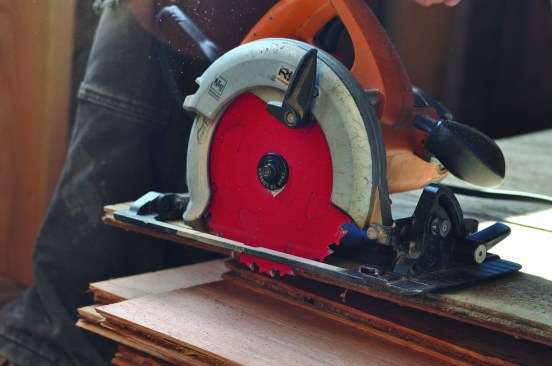

The blade depth should always be set  no more than 1/4 inch past the depth of  the material that you are cutting.
