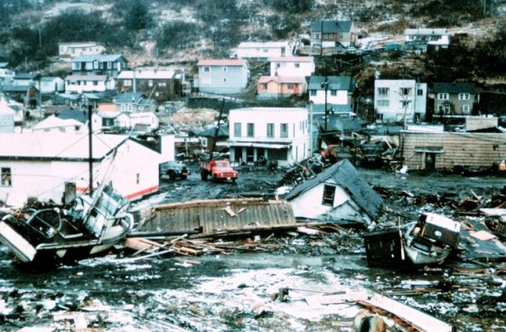

Tsunami damage at Kodiak following 1964 Good Friday Earthquake
NOAA Photo Library
