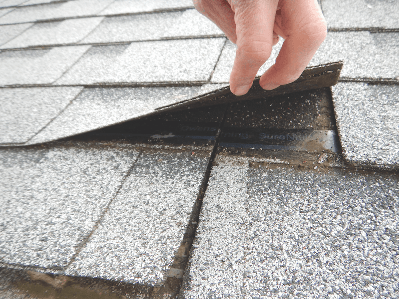

Shingle nailing. Shingles must be nailed at the ends, which did not happen in the roof pictured.

  • Shingle nailing. Shingles must be nailed at the ends, which did not happen in the roof pictured.

  • Nailing problems. Shingles are nailed haphazardly. In many cases, nails were left out entirely, especially at shingle ends, or nails were overdriven or crooked.
