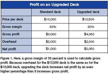

Let’s say you design a $10,000 deck with pressure-treated decking and rail that takes a two-man crew seven days to build. Your gross profit (before overhead is deducted) should be $3,000 on each deck; if you run a couple of crews and build 60 all-wood decks a year at an average price of $10,000, your total annual sales will be $600,000 and your annual gross profit will be $180,000.
If, however, you sell your customer a composite-decking upgrade that raises the sales price by 35 percent to $13,500, your gross profit on the deck (assuming you keep the same margin) will increase from $3,000 to $4,050 (Figure 1).
By converting just one-third of your wood-deck sales to composites, you could increase your annual sales by $70,000 to $670,000 and your gross profit by $21,000 to $201,000 — an 11.6 percent increase in gross profit (21,000 divided by 180,000). Your net profit will show an even higher percentage increase because of the way overhead costs work.
