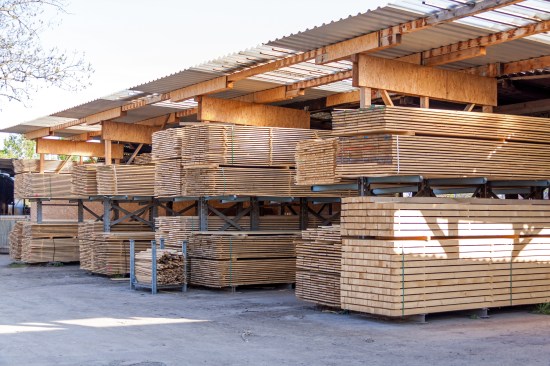

1. What building materials and components are the most problematic for you in terms of price volatility or availability/wait times? This one is pretty obvious to most readers. Lumber stood out the most as a source of pain on the price front, with more than 73% naming lumber, called out as rough lumber, sawn lumber, softwood framing stock, dimensional or 2x material.
Sheathing, both plywood and OSB, was called out specifically by 63% of respondents. And treated, or PT wood, named by 42%.
