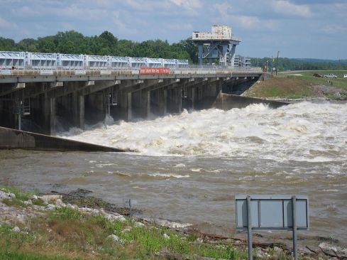

Mississippi River water discharge into the Atchafalaya, Old River Control Structure, Louisiana. (photo: Tobin)

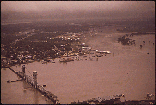

Near Morgan City, La., in 1973, the Mississippi river reached its highest level in more than 150 years. Unprecedented flooding occurred throughout the river basin. (photo: National Archives)

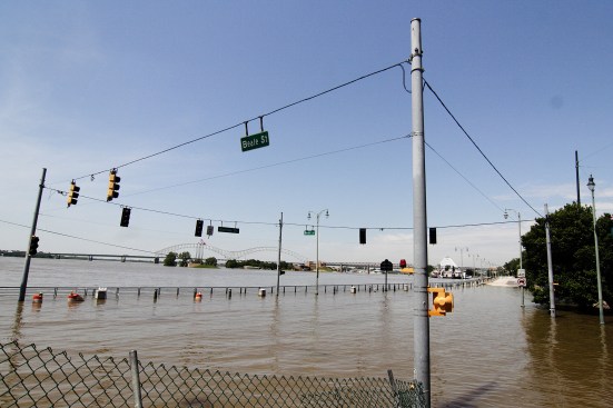

Flooding at Riverside Blvd. and Beale St. in downtown Memphis, Tenn.; part of the 2011 Mississippi River floods (photo: Thegreenj)
