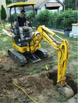

Kids on the Job Site
Kids think deck builders are cool. The equipment looks powerful, the noise from the tools is exciting, and job sites look like fun places to hang out. However, it’s hard to extinguish kids’ desire to wander over to the backyard job site when you’ve left for the weekend.
If someone gets injured on your job site, you are responsible and may be liable for any injuries. It doesn’t matter if you’ve posted signs, wrapped everything with caution tape, and asked your clients and their neighbors to tell their kids to stay away from the potential dangers.
Kids may not know that the machine could move or the dirt pile around the post hole could give way. And unlike adults, children aren’t legally expected to realize potential dangers around them, so the owners of construction equipment and job sites are responsible for taking measures to make sure trespassing kids will be safe.
Liability for trespassers’ injuries on construction sites varies slightly from state to state. Talk to your insurance agent and lawyer for the specifics on how your state handles what is referred to as an “attractive nuisance.”
