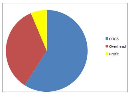

To start, let’s consider the total dollars coming in as a result of sales as a lump amount represented by an undivided pie chart.
When considering INCOME, remember that the total dollars coming in will be distributed to one of three places:
• Production costs (COGS)
• Overhead
• Profit
So the pie will be the same size as the income pie, but divided into three slices.
Because we know that if you want to count on getting profit, it’s wise to consider it just another overhead cost, we can combine Overhead and Profit, so now that same size pie has only two slices.
And because we also know that gross profit will always equal the sum of Overhead and Profit, we can rename Overhead and Profit as Gross Profit.
So now let’s just add some letters to identify the pie and slices: Let’s call Income “A,” COGS” B,” and Gross Profit “C.”
