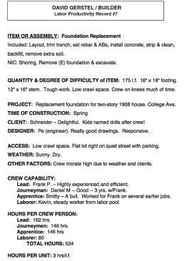

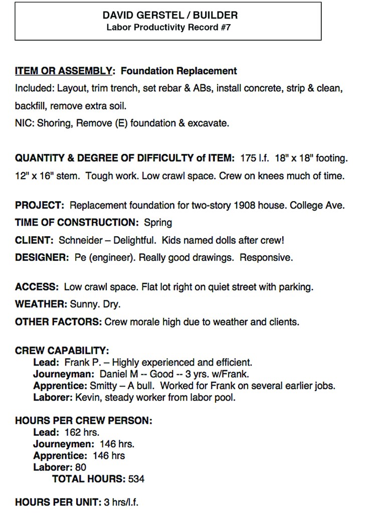

There is a much better alternative for estimating labor productivity: It is described in a five-word phrase, which we will break down word-by-word. Here’s the phrase: Narrative Historical Labor Productivity Records. In my new book, there are eighteen samples of such records. One is shown here, below:
Sample labor productivity record. Think of a productivity record as a narrative telling the story of an installation, in this case of a foundation replacement. Like any good story, it includes characters, time, and place—the crew that did the work, the time it took them to complete the work, and the site where they performed the work. Crucially, the record boils time down to a unit cost, which in this case is hours per linear foot, that can be used in future estimates.
The records are narratives because they tell the whole story of the installation—in the case of the illustrated sample, that is the story of installing a new foundation in place of an old one. Every story involves characters, place, and time. As you can see in the record, the story of the foundation involved four primary characters—the crew members Frank, Daniel, Smitty, and Kevin—and also a capable engineer and good clients. It took place on a sunny, dry, flat site during the spring. And it used 534 hours of labor—or 3 hours per linear foot.
The records are historical because they report actual events. In other words, the hours per unit productivity figure is nonfiction. It’s the real deal. It is not the sort of fictional average you encounter in cost catalogues.
The records are about labor productivity because you get a labor productivity number, a cost per unit of work—in this case, the 3 hours of work per foot of new foundation—on the bottom line. That unit cost is useful! It’s what you are after. Here it is figured for 175 feet of foundation. But if a future project includes 142 feet of foundation replacement to be built by a similarly capable crew under similar conditions, you can apply the unit cost and estimate that the new work will take 426 hours (142 x 3 = 426).
And the records are records, because they are not mere memories but are written down.
In summary, what we have here are narrative historical labor productivity records. For short, you can think of them as “labor productivity records” or just “labor records.” When I first began keeping my labor records, I wrote them out by hand on a pre-printed form. Now I word process them, print them out, and organize them in a three-ring binder. I find it very efficient to just flip through the pages in the binder, coming to records for items in the same order—the natural order of construction from foundation through finish—as they occur in my estimating spreadsheet. But you might prefer to keep the records in a computer folder, in turn divided into subfolders, one for each division of work in your estimates. You can then open subfolders for the relevant divisions and click open the needed records for items and assemblies as you work your way through your estimate. Whether they are in a binder or in computer folders, after building many estimates with use of your productivity records, you will hardly need to refer to them. You will have them memorized. You will move fast, yet produce accurate estimates.
