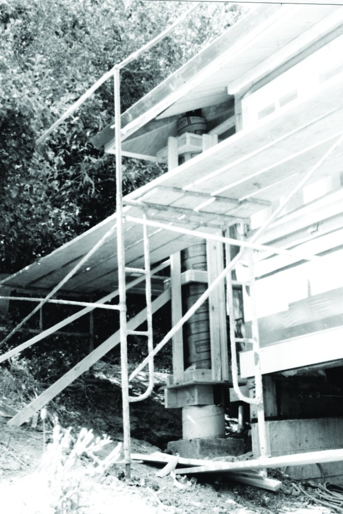

The stepped concrete column (whose formwork is visible behind the scaffolding) was costly to construct for several reasons, including complexity and difficult access. Most impactful, the column was to serve as a prominent finish item, so all forming and concrete installation had to be meticulously controlled.
Photo excerpted from Nail Your Numbers

Some of the most potentially damaging of the finish slipperies pop up in designs that require you to produce structural elements that double as finish. Consider the column shown in the photo on the facing page. Such items can require labor several times what would be needed for the same installation if it were hidden from view, not functioning as finish.

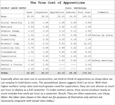

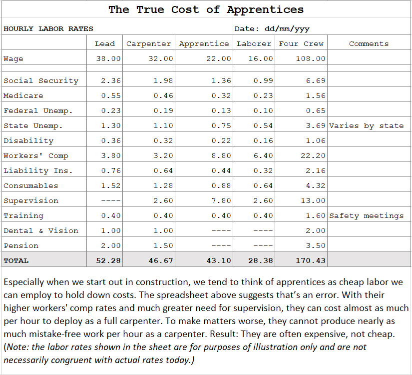

Click to enlarge

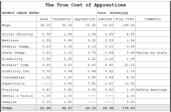

Apprentice labor may well be the most significant of the elusive items for builders who employ in-house crews. The real cost of apprentices often is misunderstood and severely underestimated. When you factor in the much higher workers’ comp rates for apprentices along with the supervision they require, their hourly cost can run close to that of journey-level carpenters. If they are deployed to tasks beyond their skill level, their inefficiency and mistakes will push their cost per unit of production far past that of full carpenters. Therefore, during estimating, you need to use their base rate only for those simple repetitive tasks at which they can be efficient and effective. If you anticipate deploying them to more complex work to keep them busy, you must either jump up their rate or allow for very low productivity.
