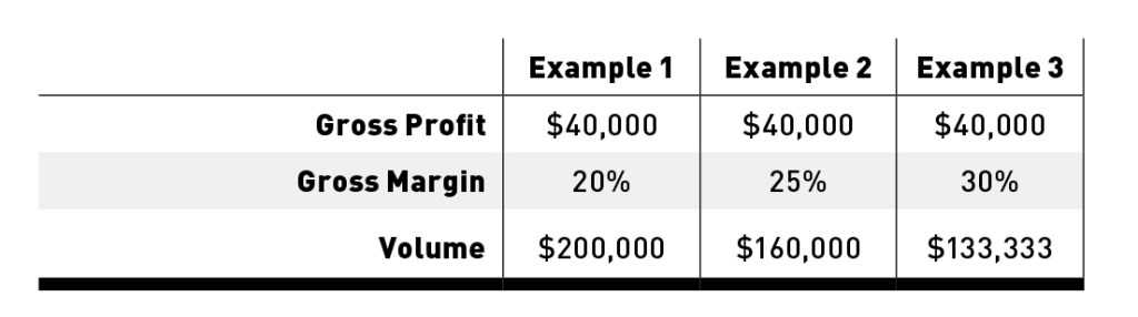

Different Margins Yield Different Volumes
If you know your gross profit and you experiment with various margins, you can see the theoretical sales volume required to meet your overhead and target profit.
Gross Profit ÷ Gross Margin = Sales Volume

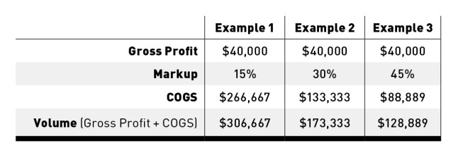

Different Markups Yield Different Volumes
If you know your gross profit and you experiment with various markups, you can see the theoretical sales volume required to meet your overhead and target profit.
Gross Profit ÷ Markup=COGS | Gross Profit + COGS = Sales Volume (Income)

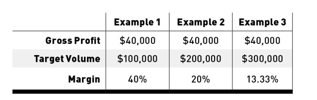

What Margin Do You Need to Meet Realistic Volumes?
Now let’s rein in the sales volume to get some realistic numbers for, in this example, a small volume remodeler. (You may be comfortable with a larger volume, but we’re going to start off conservatively. You can grow from here.) If you know your gross profit and you experiment with various possible realistic sales-volume amounts, you’ll see what margin would need to be achieved at each sales volume in order to meet your overhead and target profit figures.
Gross Profit ÷ Target Volume (Income) = Margin

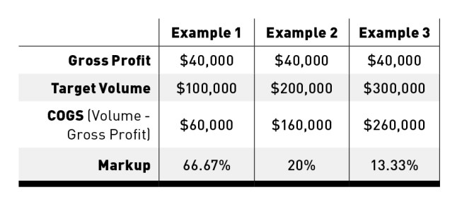

What MarkUp is Needed to Meet Realistic Volumes?
Taking these same realistic volume figures, you can calculate the markup you need to apply. Then, using the markups, you can price your jobs accordingly, secure in knowing that you will actually make a sustainable profit, provided you hit your sales volume target.
Gross Profit ÷ COGS (Target Volume − Gross Profit) = Markup
