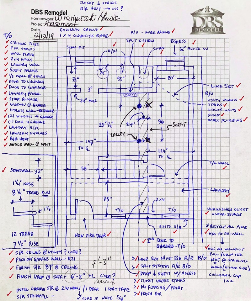

The author takes quality jobsite notes, jotting down what is not included, what to tear out (t/o), any perceived difficulties, and general site conditions. Here, for a recent finish basement remodel, he checked off the items with red check marks as he brought them into his job scope and estimating program (applying hours and quantities to do each task).

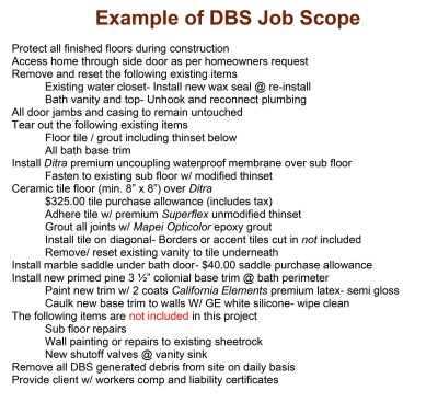

For instance, if we are remodeling a bathroom, we don’t just say that we’re going to drywall and paint. We write in the job scope that we are installing moisture-resistant drywall; fastening all drywall with screws; taping all seams and applying three of coats of compound; feathering new drywall into existing as required; wiping down all drywall prior to painting; and applying two coats of Benjamin Moore Regal Select with an eggshell finish. Being specific builds value. Or, if the client has a particular pain point, such as a child with asthma, we write in the scope’s home-protection-and-care section that we will run an air scrubber with a HEPA filter ducted to the outside that will remove the bulk of the dust particulates during the remodel. Clients will often note that “the other guys didn’t tell us this.” The idea is to set ourselves apart from our competition. Being cognizant of the clients’ pain points and having a plan to deal with them helps us to build value and sell the job at the number we need.

Step 2. Take detailed job notes. The second step is to take quality notes while walking through the entire work area. During the interview process with the clients, note what is not included and what is to remain untouched, what to tear out, any perceived difficulties, and site conditions (see image of job notes, above). These notes are the head start of our job scope, and we use them to build it and the cost analysis later on. We are going to review the notes again with clients, and they may change their minds on certain items, but that’s OK.

A precise job scope is written clearly and in layman’s terms. Here, a portion of a job scope for a bath remodel shows the author’s simple but effective layout, or “the art of indentation.” Noting what is not included is as important as noting what is included.
