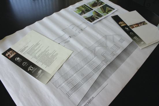

With a signed CPE agreement in hand, it’s time to get started with Design, and the first decision is who will do this work. For additions and major renovations, we subcontract to a professional designer who is also a licensed architect. For our kitchen projects, we use the retail company that we purchase our cabinets from (they offer us this professional design service free of charge). All projects such as bathrooms, lower levels, porches, decks, and the like, we design in-house using Chief Architect as a design presentation software.
Next, I capture digital images of the entire work area to share with the Design team. These images will also be used to develop the Cost Analysis.
If the project requires design assistance from my architect, then we schedule our next appointment. Prior to this next meeting, I share some thoughts with my architect regarding the homeowners’ intentions and budget range. During this first Design meeting (at the clients’ home), my role is to facilitate the discussion and make sure the architect and the homeowners are communicating effectively with each other.
At an agreed upon later date, we return to review the drawings and make necessary changes. When this process is complete, we have the homeowner sign off on the drawings, and we start the Job Scoping phase.
With a kitchen remodel, I create an informational packet for our showroom kitchen designer. Included in this packet are digital photos of the kitchen space and a detailed, hand-drawn floor plan with all required measurements. I also interview the clients to learn what they like and don’t like about their existing kitchen—crucial information to pass along to the designer.
Once I’ve dropped an information packet off and reviewed it with the kitchen designer, we are ready for the clients to visit the showroom. Again, at completion of Design, we have the clients sign off before moving forward with the Job Scope.
For all other project types, I start the in-house design process immediately after signing the CPE. For this process, we rely on client suggestions, our job portfolio, Houzz, and my experience.

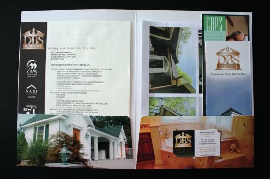

During each client visit, I always bring my prepared documents in a DBS Remodel presentation folder. At the first visit, I give one of these to the clients to keep all their documents organized. As I am closing the deal, we review the amended Scope for the last time. Any change from here on out will be executed through a change order.
I never include the investment figure on the scope document. Ultimately, everyone goes to the last page looking for it. I tell them it’s not there because I want them to focus on understanding what they are purchasing first. When all questions have been answered, and they understand what they’re buying, I unveil the projected cost for the project.
