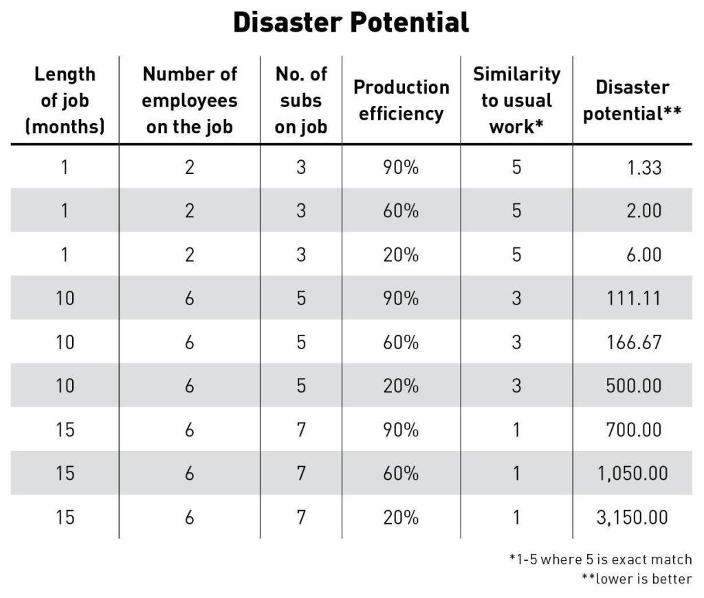

Risk goes up the more a job differs from a typical project. To calculate disaster potential, multiply the first three columns, then divide by the last two in succession.

My rule of thumb is that a company’s inefficiencies and poor practices will be magnified according to a job’s size and how different it is from a typical job (see table, “Disaster Potential”). I measure job size by its duration and the number of employees and subs involved. How similar a job is to other work is a subjective assessment of how much the job will stretch you and your crew beyond what you’re comfortable doing on a regular basis. For example, if you specialize in remodeling 5×8 bathrooms, building a new 5,000-square-foot home would be a big difference.
