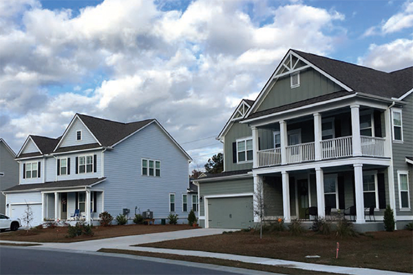

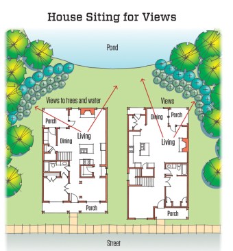

Site orientation. Investing a small amount of time to consider both sight lines and orientation can increase the appeal of the house and add thousands of dollars to the selling price, while cutting the time that the house spends on the market. Even the smallest consideration, such as using a mirror image of the plan on a particular lot, can make a tremendous difference to potential buyers when they walk into the house.
These two homes are sited and arranged so that views from the living spaces look out to natural settings. Windows that look from one house to the other are kept to a minimum.
Tim Healey
Room views. Ask yourself what the views will be from the living spaces. The two best answers are trees and water. Invest in plantings that enhance the views from inside the house or make the most of that retention pond behind the property.
Select house plans that can be oriented on the site for the most advantageous views. That might mean rearranging plans to put the living spaces in the front of the house or facing the side. As you review the plans, be sure to check the views from the master bedroom and bath. If those areas look into private areas of the neighboring house, you might want to rethink the plan. The bottom line in most cases is that open vistas are far more desirable than views of adjacent houses.

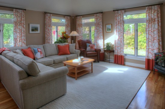

4. Provide Lots of Natural and Artificial Light
Most people thrive on natural light, and well-placed windows can sell a house almost as quickly as a gourmet kitchen. Buyers will feel alive and uplifted as they walk through a house with lots of natural light. The size and placement of the windows are key factors for first impressions, and, like color, these factors are driven by the natural environment of your region. Again, look at images in local design magazines for ideas for the size and placement of windows.
Natural light. Window arrangement should be compatible with the furniture placement that’s typical for any given room. In the master bedroom, allow for enough space between windows for a king-size bed. In the dining area, install small higher windows flanked by larger ones that provide ample daylight and privacy, while leaving a space below for a sideboard. Windows in children’s bedrooms should be 30 inches or more off the floor to prevent accidental falls and to allow for bookcases or desks under them.

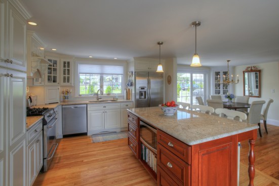

5. Make the Kitchen a Focal Point
The kitchen is the biggest emotional button likely to change a home browser into a home buyer. Kitchen location, size (a kitchen should occupy at least 15% to 20% of the first-floor living space), color, appliances, plumbing fixtures, and finishes should be at the top of your priority list. And keep in mind that good color costs no more than bad color.

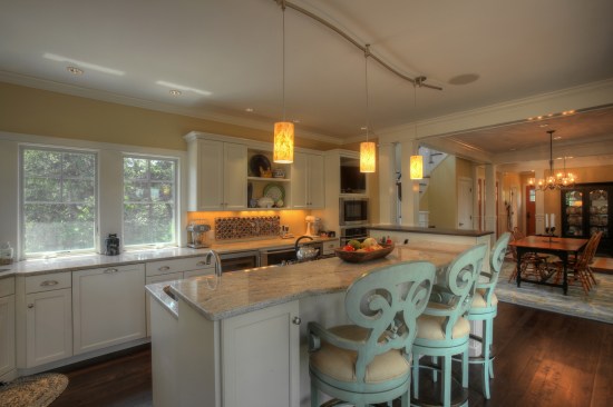

Install kitchen appliances are the best quality and most up-to-date relative to the price point of the house.
Roe Osborn
The kitchen must be commensurate with the style of the house and the demographic of your buyers. Don’t be tempted to use “builder-grade” materials for any part of the kitchen. That doesn’t mean you need to spend 20% of the budget in this room; it simply means that if you skimp, this is where it will be most obvious.
Appliances. Most important in a kitchen is that the appliances are the best quality and most up-to-date relative to the price of the house. If gas is a sought-after feature in your market, include it. Next, use finishes that are striking, on-trend, and in keeping with the style of the house.
Counter space. Another sought-after kitchen amenity is ample counter space. Currently, the trend is for large islands with flush countertops and space for seating, rather than small islands meant just for cooking. Potential buyers also look for smart work areas. While symmetry might look great, it makes for awkward cooking. Don’t place a sink directly across from a cooking surface, or two people will find themselves back-to-back while working in the kitchen.
Traffic flow. Establish an easy traffic flow from the entry door to the kitchen, and provide a landing space for groceries near the refrigerator and pantry.
Pay special attention to kitchen lighting. If you install pendants over an island, make them special. An extra $50 or  $100 spent here can translate to thousands in the perceived value of the home.
Roe Osborn
Lighting. Finally, pay close attention to the lighting. You’ve already been warned not to use fluorescent lighting in a kitchen. If your budget allows for pendants over an island, make them memorable. The difference between a $50 fixture and a $100 fixture could mean thousands in the perceived value of the home. The same is true for hard-wired under-cabinet lighting. It can cost as little as $50 per line, so add it. Your competitors likely won’t.

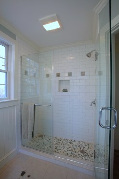

Roomy, well-lit master bathroom showers tiled from floor to ceiling have become important selling points in spec-homes and can actually cost less than the once-popular whirlpool baths.
Roe Osborn

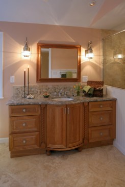

Master bath. The layout for the master bath needs to allow two people to use it comfortably at the same time. A whirlpool bath is no longer a priority, while a large shower has become more important. Re-allocate the cost of the tub to the shower stall, increasing its size and tiling its walls all the way to the ceiling. Make the shower the focal point of the room. If the house is in a middle- to higher-price bracket, include a frameless glass shower surround to let in plenty of natural light and offer natural views of the outside.
With a spec home in a higher-price bracket, place a freestanding soaking tub near a large window that looks out at a private natural setting, to create the feeling of an intimate oasis. Windows in any bathroom should never face a window in an adjacent house. The ideal location for the master bath is on the side of the house that is the most private and offers a view from the shower. A toilet room is desirable in a higher-priced spec home and is best placed close to the bathroom door for easy access.

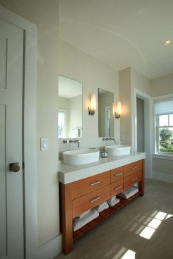

The master-bath vanity should have two sinks if space allows and at least one bank of drawers for storage. For the look of a more expensive house while actually saving money, install two framed mirrors—centered over the sinks with single sconces flanking them—rather than a slab mirror that extends over the entire counter. Plumbing fixtures should be on-trend and reflect the style of the house. And the color of all finishes should coordinate with each other and harmonize with the colors in the master bedroom.
Save money in the master bathroom by installing two smaller mirrors over the sinks instead of one large mirror. The smaller mirrors add a more personal "his and hers" feel to the bathroom as well.

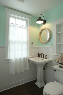

Powder room. Don’t underestimate the positive effect that an attractive powder room can have on potential buyers. It might be the first room they ask to see after walking around all day looking at houses. Make sure it’s not placed in or adjacent to a room where people gather. A better option is an out-of-the-way place where sound won’t be transmitted and where people feel less exposed while using it. Don’t be afraid to dress up the powder room with high-quality finishes, dramatic color, and a unique sink to set it apart from a standard bathroom. The room is usually small enough that the cost to create a dramatic effect is minimal. In fact, a piece of finished reclaimed wood on brackets with a vessel sink on top makes an impressive statement for less than a vanity would cost.
A window in a powder room is a value-added feature, but remember the rules about sight lines through that window. If it is an interior room, pay close attention to ventilation. Install an exhaust fan that is quiet yet powerful enough to eliminate odors quickly. The powder room is another place where lighting can have a positive effect. If space allows, sconces are a better and often less-expensive alternative to an overhead vanity light.
A powder room can be dressed up with high-quality finishes and unique plumbing fixtures to set it apart from a standard bathroom. The small size of the powder room help to keep extra costs to a minimum.
