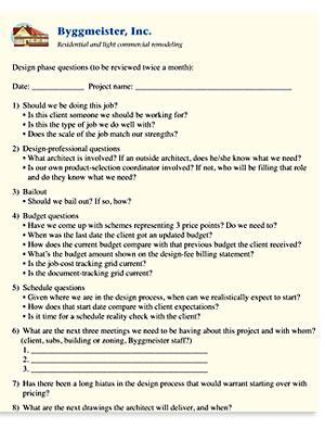

Having learned all this the hard way over a number of years, our company now uses a worksheet (see checklist) to help keep design jobs on track. This form forces us to ask the right questions — and get useful answers — frequently enough that we’re less at risk of losing momentum or control.
This worksheet forces the author’s team to ask key questions at critical junctures.
In this article I’ll go over the questions on the survey and the reasons it’s so important to ask them.

How We Use the Worksheet
My estimate coordinator and I meet with each architect or designer at least every other week. At these meetings we run through the worksheet for each design project. I keep a separate worksheet file for every project. Nothing but the worksheet is in this file; other project information and paperwork are kept in a different project file.
The files are color-coded based on the architect or designer — blue for Anita, red for Doug, yellow for Jeff. This makes it easy to pull all the right files for a particular designer meeting. We go through the files one by one, reviewing past worksheets for each project and filling in a new one for that meeting. I keep my laptop out and type action items into an e-mail as the meeting proceeds. This, I’ve found, is more reliable than waiting until after the meeting to write up the notes.
In this manner, we’ve learned to track design projects in a much more organized and proactive way. I can’t say we’re 100 percent reliable about every step in the process, but we’re getting better. And if things fall apart on a project, we’re able to quickly identify why the breakdown occurred, so we stand a better chance of avoiding the same problem in the future. The net result is that we’re able to handle more jobs in a less stressed, more controlled fashion — and that, of course, is to everyone’s benefit.
