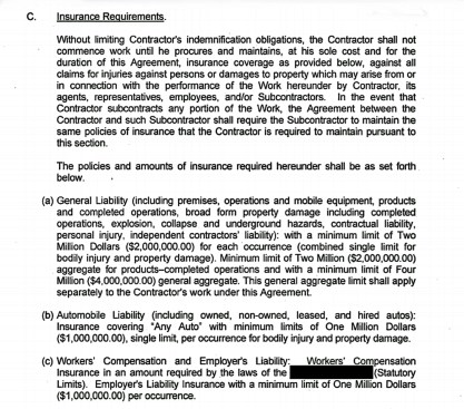

Sample of contractor insurance requirements as stipulated in a contract.
