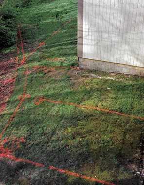

On more complicated builds, I draw the top view of the deck on the ground with marking paint (Figure 1), including all steps, landings, beams, and posts. This process either confirms that the design will work as drawn, or brings to light the need for slight modifications. Adjusting deck placement to have a set of steps land on existing concrete is easy before starting construction. Adjusting the same deck after building has begun can be a real headache.
Figure 1. By painting the plan view right on the ground and locating the layout for all the posts, beams, steps, and stair landings before construction begins, you can avoid costly, time-consuming adjustments later on.
